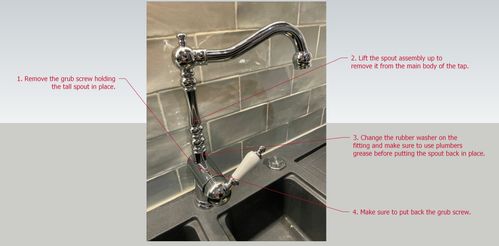

We have the “Mondella Maestro 35mm Chrome Lever Handle Sink Mixer” kitchen tap and it was leaking so we went to Bunnings and the staff gave us 2 new O rings out of the demo tap and we put those into our tap and covered them in Hydroseal. At first it’s nice and loose but after about 10 swivels it goes partly stiff again, and then I leave it for an hour and it’s very stiff. I’ve done this multiple times and cleaned out the gunk and even tried a spare tap (top part), and spare nylon washer inside in case it was that but it hasn’t helped.
I can’t think what the issue could be, especially as it’s nice and loose after lubing and then goes stiff again quickly. Are the new O rings from the demo bad, or is the Hydroseal not working?
Any
help appreciated.
