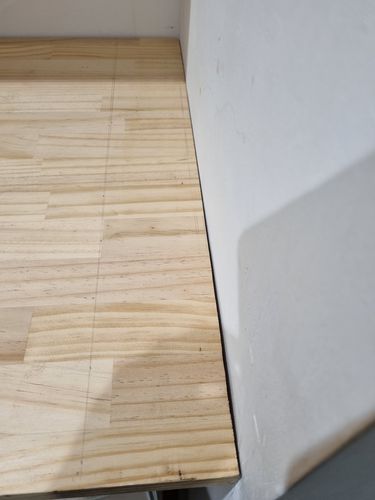

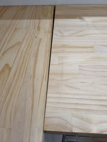

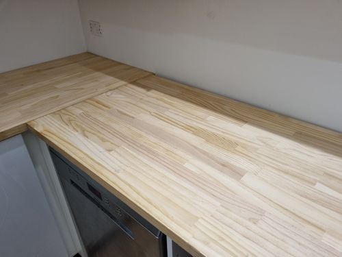

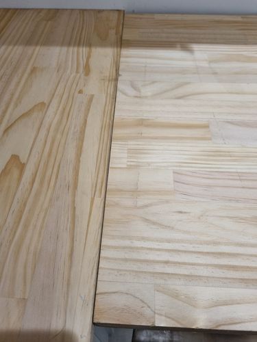

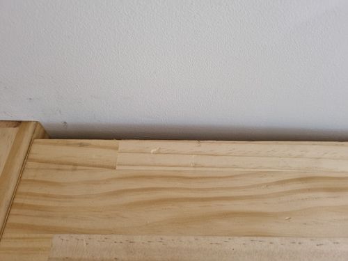

Holy mackerel guys, I've been at this for ages and it's got me stumped. I've also got a raging lurking which isn't helping. All measurements are equal, I've used a metal square to check corners of board and walls...so why is it still wonkatated? Its abutting onto another slab of pine. If I get it nice and neat on the left abutting the other benchtop, there's a big gap at the back left of slab. If I get it nice and neat against the wall on the right, I get a gap along the left abutting other benchtop. I just can't work out how to fix this so I can go back to bed with a Lemsip!

Benchtops are always installed last because walls are never straight. You need to *scribe* the edges to match the adjoining surfaces to ensure it fits snuggly. Cabinetry and walls are rarely perfect at 90-degree angles.
If you install some sort of splashback (i.e tiles with a silicone bead at the bottom), then this will cover the back edge of the benchtop. You should also do a silicone bead along the side of the benchtops at the wall too.
Packers underneath the benchtop will get it exactly level too if it's not millimetre perfect.
