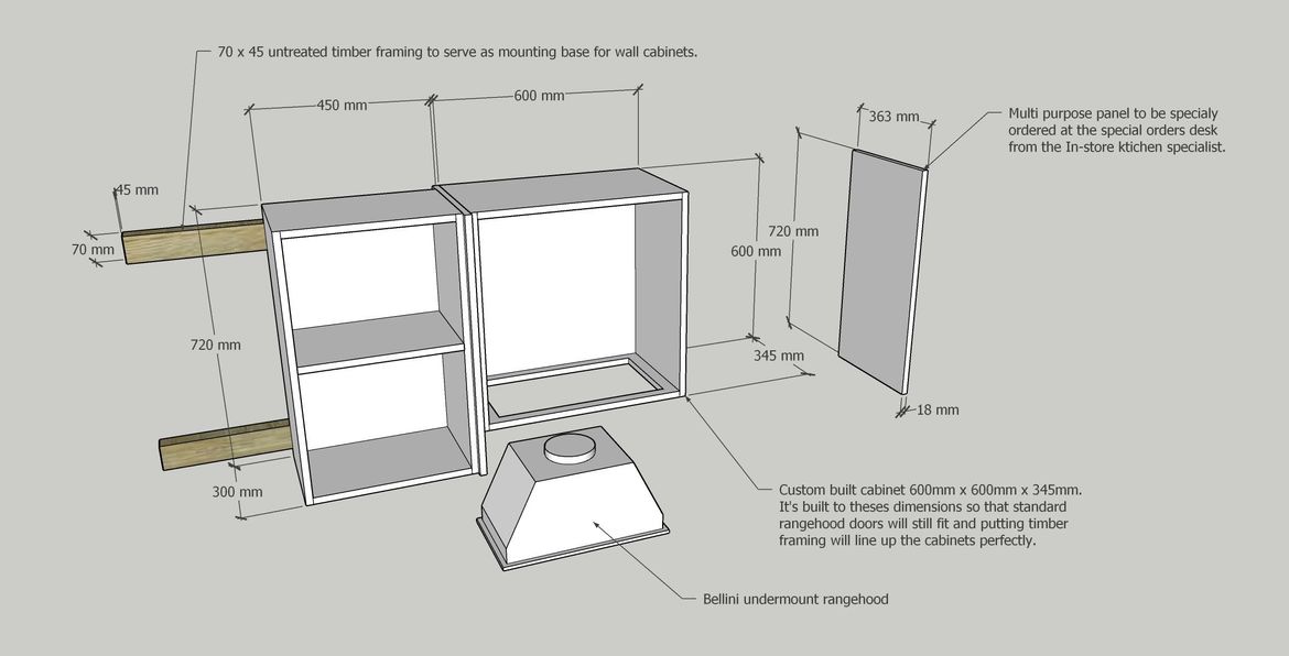

My apologies for the late reply. I was rolling the problem in my head when it occurred to me that you can still make it work, but you will have to build a custom-sized range hood cabinet. I suggest retaining the standard outside dimensions of a Kaboodle 600mm Rangehood Cabinet but making it 345mm deep. The reason for this is that you can place 70 x 45 untreated timber behind the regular cabinets and still have all the wall cabinets lined up to the range hood cabinet. Plus you can still use standard range hood doors for the set.
I've placed a sample sketch below of how you can put it together. Please have a look and tell me what you think.

Hey Eric
Thank you very much for taking the time to work through this, much appreciated.
We looked at a few options similar to what you proposed but recently ended up swapping out the undermount and getting a pull out one instead (from Bunnings!), Made life and time much easier on our budget.
Appreciate your help!
