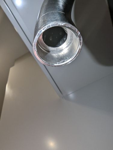

Our kitchen faucet has no aerator/end piece and the water comes out quite fast and splashes etc. Is it possible to add an end piece to help smooth and possibly slow the flow? I have attached a photo of the faucet end! Thanks for your advice!

Can you see if this piece like in the image unscrews at all? If it does I'd take that down to your local Bunnings and into the plumbing section and the isles with all the copper pipe fittings and angles and the aerators are there and you may find an end that will replace that.
You will not find an aerator that will fit what you have existing unfortunately because what was there was pressed in and it has fallen out.
If you can't unscrew the tip or fin a replacement you may be looking at a new complete unit unfortunately.

Thanks for sharing your question about your faucet aerator. Is there a chance that you would happen to know the brand and model of your tapware? This would be the easy way to replace the missing aerator of your faucet. It is a very particular type and is installed with a special tool.
Another option is to remove the aerator housing still attached to the spout of your faucet. You'll notice that at the tip of the spout is a very faint line, this is the join between the spout and the housing. In order to remove the housing, you'll need to use a multigrip and a soft cotton rag. Wrap the rag on the housing and use the tool to turn it anti-clockwise.
Once you've removed the housing, I suggest bringing it to the plumbing department of the store and compare it to the aerators available. I suspect that one of the Enduraseal units should fit your spout.
If the aerator is not compatible, please let me know.
It does unscrew! Thank you so much - I will take it to Bunnings and see if I can find something! Thank you again!
