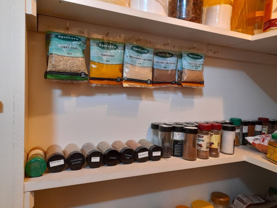

I want to install two shelves in my pantry to house my spice jars which will be placed horizontally like the ones in the left side of the attached photograph.  The width of the shelving only needs to be 10cm deep and the width of the length of the wall is 100cm.  I would like two shelves placed from the top of the wall, so this leaves plenty of room underneath for other things.    What type of wall do I need and what type of supports?

Looking at the picture you posted, there is definitely room to add more shelves. I recommend using Tasmanian Oak DAR 90 x 18mm 1.2m Porta. It can be cut in the middle to make two 600mm length shelves. However, if you wish to use the entire length of the pantry side you will have to get a longer piece of timber.
I suggest using Carinya 70 x 70 x 20 x 2mm White Round Angle Bracket - 8 Pack to hold the shelf in place. I've attached a basic drawing for the layout. Please note that the measurements for the spacing are just recommendations, please adjust them to your needs.
