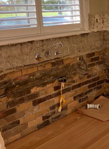

I am getting ready to install my kitchen and wanted to sense check my plan for attaching an ikea suspension rail.
Question 1

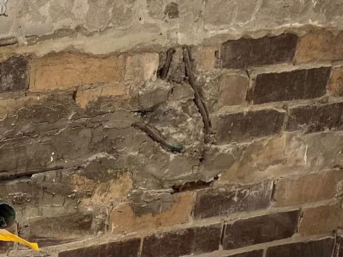

i cannot make my wall flush because of a small water pipe that isn’t chased deeply enough into the wall. I planned to use window shims behind each attachment point so the rail is level but there will be a 5mm gap between the brick wall and the rail. Is that the best approach?

It would really help if you could post a photo of the wall and the area where the pipe sits, along with a clear shot of the back of the rail to see how it’s designed to fix to the wall. Can you also let us know whether the rail is load-bearing (for example, supporting overhead cabinets), or if it just provides alignment and support? If the rail is carrying any significant weight, it’s important the fixings are secure and that the system is designed to span a gap like the one you’ve described.

Thanks Mitchell,
see pictures attached. The rail is for lower cabinets which will have front feet for stability but most of the load sits on the rail. I might put a support beam/wooden base underneath tho.
