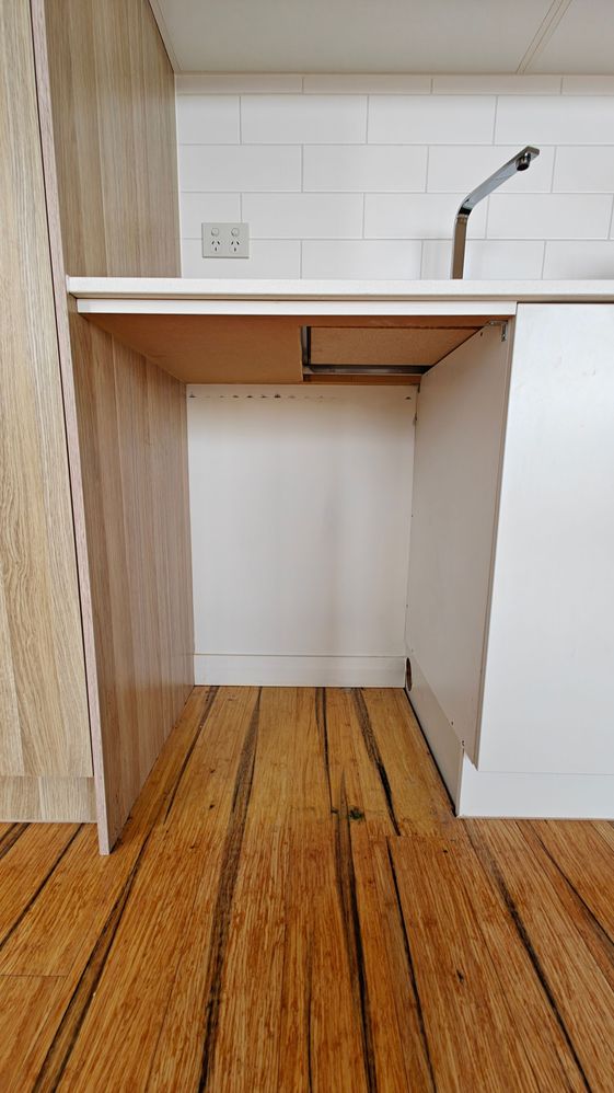

Just got into our apartment and removed the dishwasher.
We now have an empty (I'd like to call it 'available') space in the kitchen and as we're in an apartment, we'd like to put the bin in the cavity.
To keep the bin completely out of the way, I'd like to put a door on the empty cavity. Doesn't need to be the same colour as the rest of the kitchen and I also don't necessarily want to have the full slide out bin thing if it's too hard to do.
I'm not the greatest at DIY but building a simple door should surely be quite simple.
I have included a photo of the cavity and the cupboard to cupboard opening is 610mm with a height of 870mm.
If it's not too hard to install the slide out bin, I'll take a single door, with a door handle and I can move the bin in and out by hand.
Any help is much appreciated!

The simplest solution in terms of materials is a sheet of CUSTOMpine White Matt Carcass Particleboard, cut to the dimensions of the opening minus 2mm for clearance on each side. The cut edges can be sealed with Iron-on Melamine Edge to give it a more complete look.
You'd use cabinet hinges to attach the door to the opening. There's a little bit of complexity when it comes to cabinet hinges, most of which relates to how the door sits in relation to its attachment point. In your case, the logical type of hinge to use is an inset hinge, which will place the door inside the side wall, as opposed to in front of it.
These hinges need to be recessed into the door, which you can do using a Kreg Concealed Hinge Jig.

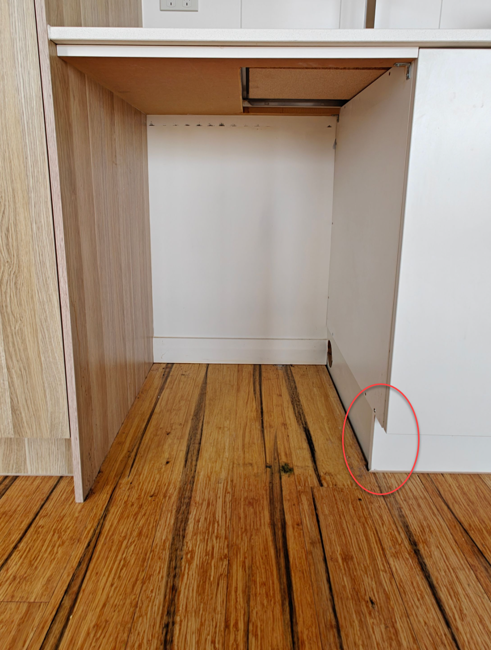

The one thing about adding a door here that would make it a bit tricky is the step back for the kickboard.
If you made it so the door lined up with the door on the right, then you would need to either stop the door at that same height and have an opening at the bottom, or have it go full height, which would leave a small opening on the right side of the door. Of the two, I think a full-height door would look better.
You'd then need to add a handle to the door. Matching the handle with the others in your kitchen makes the most sense.
The only other thing you would need to add is something for the door to close against. This could be done by screwing a strip of timber to the opposite side of the opening. Something like this 42 x 19mm 1.2m DAR Pine Standard would work well.

The cabinets come with adjustable legs @stevedoingfixes. You then clip a kickboard onto the front to cover the gap beneath the cabinet. You'll have a 10mm gap on the width, which can be filled with a timber trim piece.

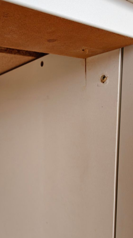

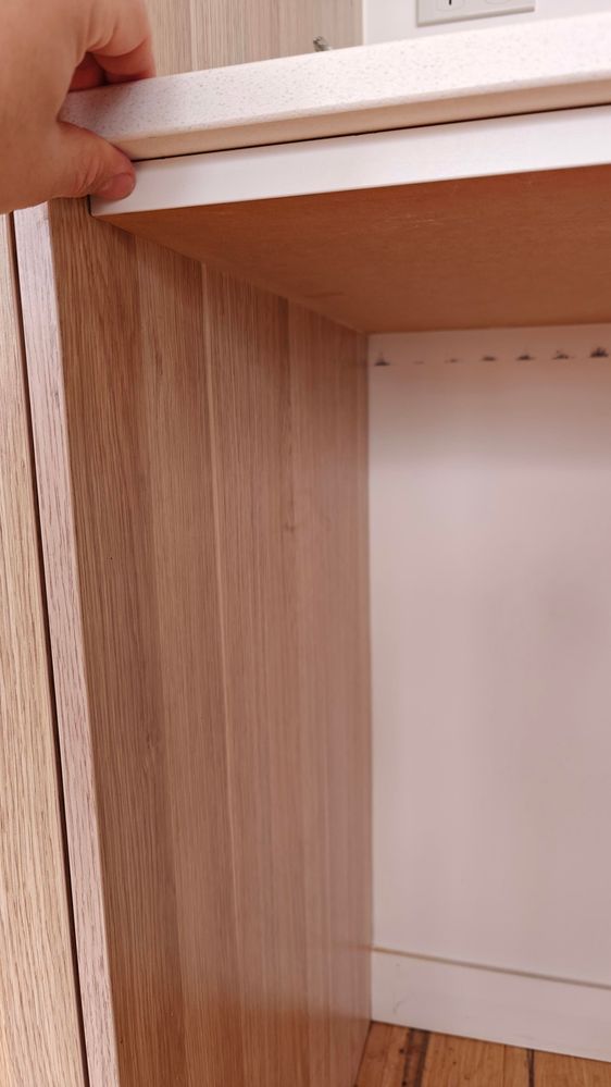

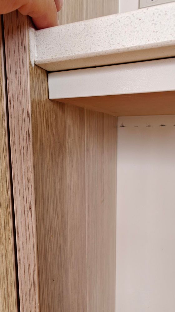

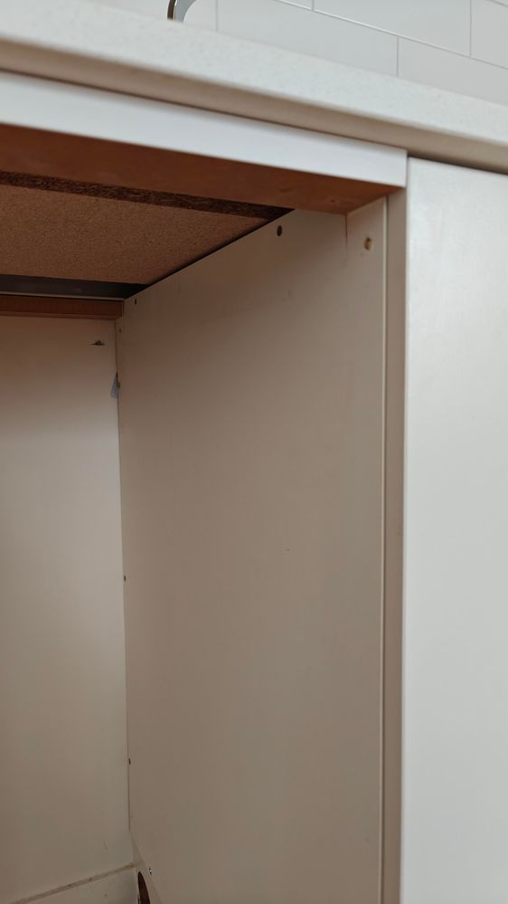

I went to Bunnings to get the cabinet. Before that however, I noticed this plank of timber sitting just below the kitchen bench.
I assume this was put in there (and cut out for the sink) to fill in the gap between the dishwasher and the bench top.
I have unscrewed the supporting brackets that I thought were holding it up but now it looks like it's glued to the bench top and it won't move.
Am I safe to pry it off somehow? Crow bar? Screwdriver? I don't wanna damage the bench top and not sure if this is actually required to be there.
The cupboard will not fit in unless this is removed.

I highly suspect that the panel is glued on to your low-profile benchtop. You'll also see from your original first picture in your post that there was an angle bracket attached to the right-hand corner which leads me to believe that you have a stone benchtop. Removing the timber support might compromise the structure of your stone top. I propose leaving it as is.
The good news is that the Kaboodle cabinet can be lowered to the thickness of the panel you currently have. The plastic feet can be adjusted so that the cabinet can slide under the panel you currently have. The drawback of course is that the lower section of the cabinet will not line up with the cabinet on the right.
Let me call on our experienced members @Nailbag and @AlanM52 for their recommendations.

That front this strip is a cosmetic infill to cover the gap from the old dishwasher and the underside of the benchtop. It shouldn't be glued in place, which doesn't guarantee that it isn't. Typically though there will be two screws securing it from each side through the cabinets and possibly 1-2 up into the benchtop.
idc you cants access these screws, I would remove any adjacent side doors and use a multi-material blade on a multitool to run up in between the side cabinet walls the top trip to cut the screws. Then run it along between the underside of the bench and the top of the trim to cut any glue or screws.
