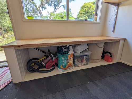

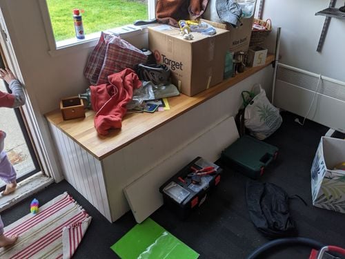

Hi all
We have this odd built-in wooden box in our sunroom (see pics). It has a loose slab of timber on top as a sort of lid, but it is very heavy and awkward to get on and off (and of course we have a tendency to put stuff on top of it). As a whole, it is not functional and we badly need extra storage space.
To make it functional, I have had the idea of installing drawers in it. My brief thought was that I could find appropriately-sized Kaboodle base cabinets to sit inside it, and cut holes in the front for the drawers. I could reserve the timber from the holes to make front plates for the drawers.
The dimensions are:
The only problem with this plan is that I'm not great at woodwork and haven't done cabinetry before! Bunnings people, is this plan doomed to failure?
Thanks for your input
Toby.
Hello @Toby1
Thanks for sharing your question about putting drawers in an existing cabinet. Your proposal of putting in Kaboodle drawers is definitely possible. However, the drawback to putting in the cabinets is their size. The Kaboodle drawer cabinets are set to default sizes and you would only be able to fit in single drawer systems. If you were to put two of them on top of one another it would be taller than your existing cabinetry.
Another option is to dive straight in and attempt to build drawer sides. This will allow you to install the Kia Ora 120 x 400 x 450mm Vinyl Wrap Drawer as a possible solution. It is a tad more involved, but it allows you more freedom for configuration. You will need to install a drawer bottom and cut out a drawer front for it but at least you won't have to build it from scratch.
Your other alternative is to build this drawer set from scratch. This will allow you to dive deeper into D.I.Y woodworking and increase your knowledge of tools and equipment. You can install soft-close drawer runners and make it as posh as you like. You can decide how deep and how big the drawers will be. By doing this project you'll be able to create more drawers in the future.
Thanks Eric! I take your point about the awkwardness of using default sized drawers.
Another potential solution has suggested itself, and one that might be less taxing on my woodwork skills: remove the front of the cabinet, reinforce it if necessary, and reattach it with hinges along the bottom edge, a catch mechanism at the top, and some way to prevent damage if it were to fall open (a short chain perhaps, or discreet rubber stoppers). This would be simple and allow easier access to the space inside. We could just slide some tubs in there for storage.
Drawers would be better, but this might be 'good enough'. What do you think?
(EDIT: Even better might be to cut the front panel into [say] three sections, and hinge each of them.)
Hello @Toby1
That is an excellent idea, it's definitely less work than trying to make half a dozen drawers. I recommend reinforcing the panels with timber so that you can use larger hinges. I suggest the larger ones such as the Hafele 105° Full Overlay Soft Close Clip-On Hinge - 10 Pack. Although you won't be using all of these hinges it's cheaper to buy them as a pack. You can always use the extra for another project.
I've placed an example below to show you what it might look like.

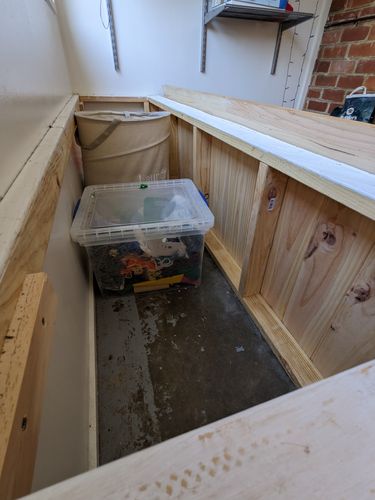

Ended up going a simpler route with this, and this is the finished product. I removed the front slats and the support structure, reinforced the 'lid' with the removed bottom beam so that you can still sit on it, boxed in the ends with the slats I took off to make it look neat, and gave the concrete floor three coats of paint. Finally, we might put a little colourful curtain on there on a cord just under the lid, to hide the contents from view.
