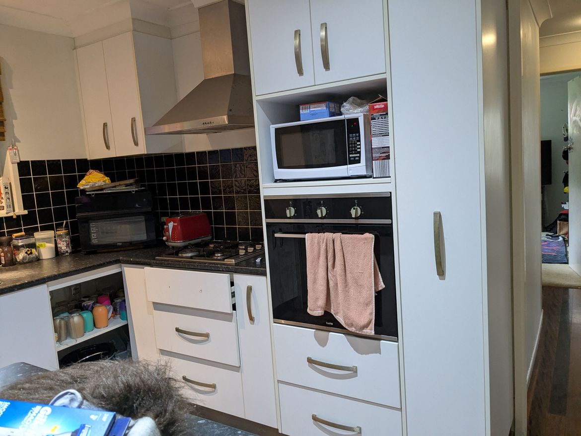

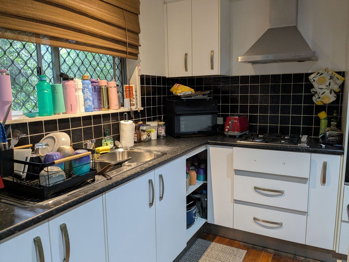

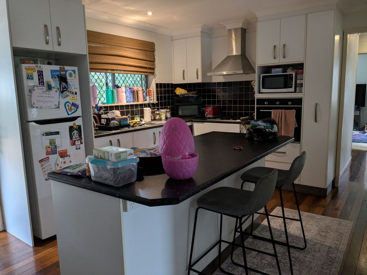

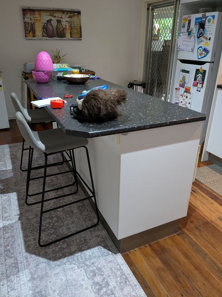

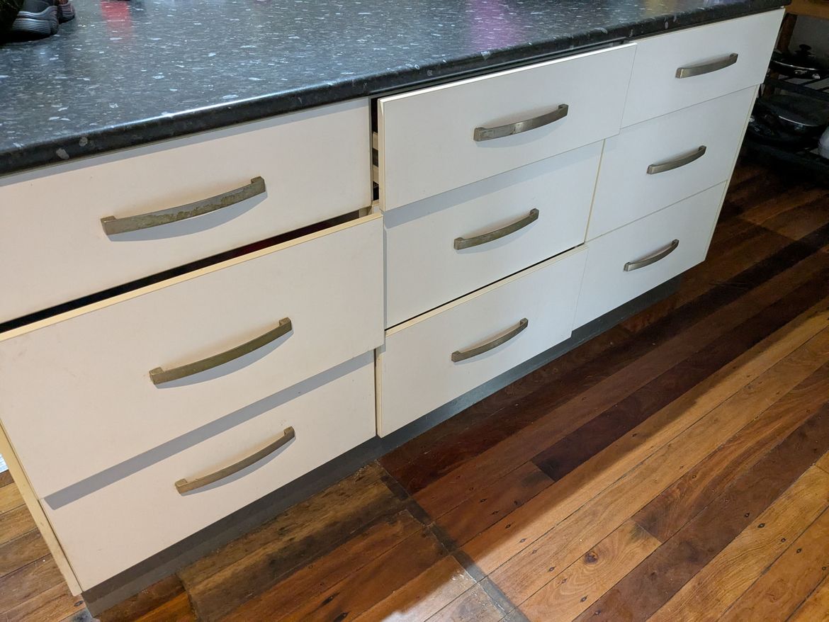

Hello,
I want to upcycle/resurface the existing kitchen island, doors and drawers to this groove kitchen.
I am thinking about using the Porta 84x12mm 2.7m White Primed Pine Portaline Dune and Selleys 350g Heavy Duty Liquid Nails.
1. Is 12mm too thick to wrap around the island, glue on the doors and drawers?
2. What paint do you recommend?
Thank you1000004723.jpg1000004725.jpg1000004726.jpg1000004727.jpg1000004728.jpg5.PNG

Thanks for sharing your question about installing Porta 84x12mm 2.7m White Primed Pine Portaline Dune in front of your kitchen doors. The weight that will be added to the doors is almost equivalent to adding an extra door in front of the existing door. For a while the hinges might be able to carry this extra weight, but eventually the hinges will give way due to the weight added. One possible way around it is to build your own doors using a thin panel and adding the Portaline in front of it so that it is equivalent to the size and weight of the original door.

Unfortunately what you're proposing isn't possible for anything other than the wrap around the island bench.
You can't add layers to the doors or drawers because simply they wouldn't operate. Cheapest option would be to spray-paint the facia's, but then there is the long term durability. If you want a sustainable face lift, then replacing the doors and drawer faces and change the handles will provide that.

- The added weight to the doors and drawers will be high, as @EricL mentions it may work for awhile but then there will be issues with hinges staying fixed and carrying the extra load.
- Movement of the doors and drawers, As @Nailbag mentions you will run into issues with opening angles and pinch points in particular.
