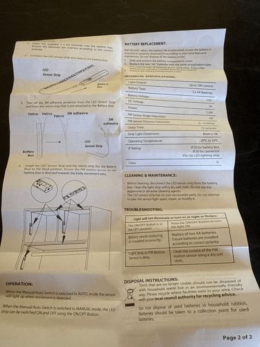

Hi, my fridge light is broken and can’t be fixed.
im thinking of installing a led sensor strip in fridge.
i found this in my home Is it ok to use for a fridge
Hi @tanyag,
It’s worth checking the Important Safety Information section of the instructions, as it likely rules out this product for your intended use. The manual states that it’s ideal for illuminating dark cupboards, wardrobes, staircases, and similar areas around the home, but specifically warns that it’s not suitable for use beyond that. It also notes that improper installation can cause fire, electric shock, or injury, and that the light should be kept away from moisture. Since a fridge is obviously a high-moisture environment, this product isn’t weather-rated or sealed to handle that, meaning moisture could get into the electronics and cause failure, or worse, a hazard. So unfortunately, this LED strip isn’t suitable for your fridge. The same likely applies to most battery-operated sensor lights, unless you were able to find one specifically designed for use in a fridge.
