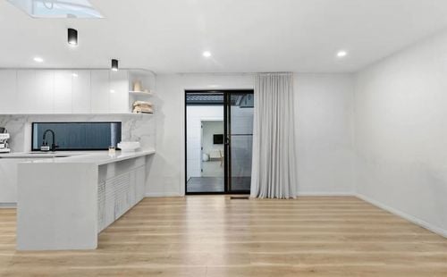

We aren’t moved in just yet so I have time to gather ideas and suggestions. Our new dining area is just screaming at me for a banquette dining seat along the wall (like an L shape). I was getting quotes for cabinet makers but it’s so expensive so I think I could potentially DIY now that I’m getting more confident. I don’t have exact measurements as of yet but once I do I will post here. I will attach photos of the current dining area and also my inspo!

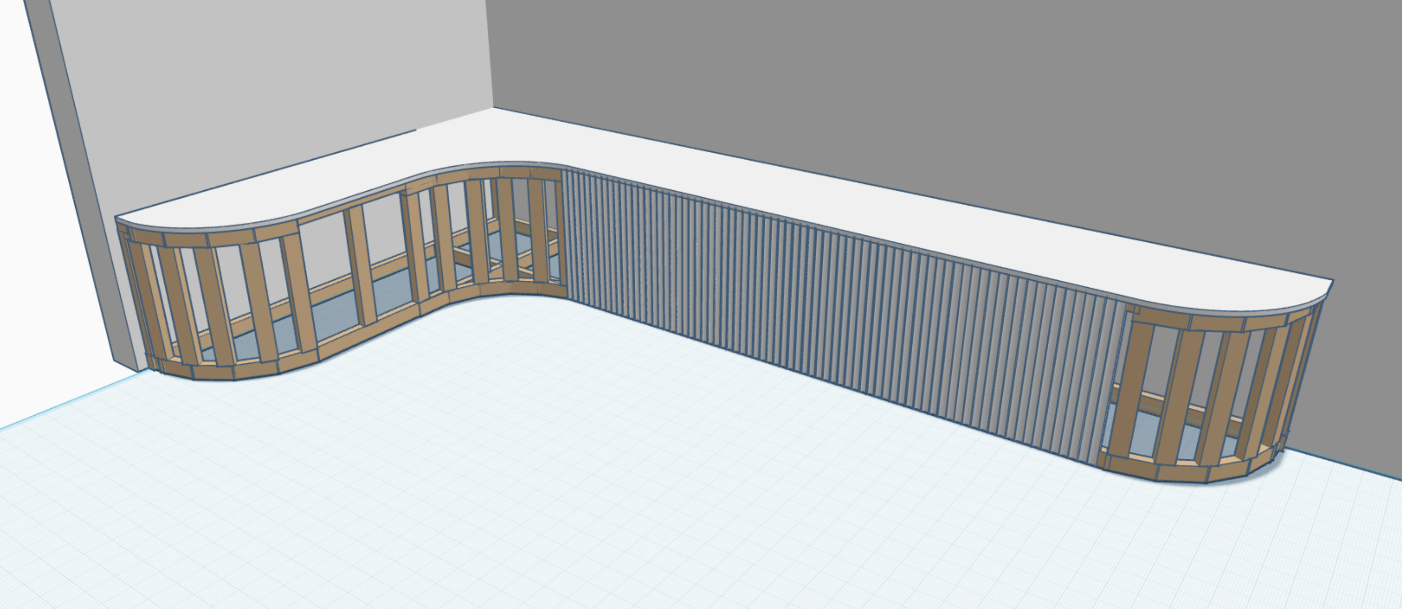

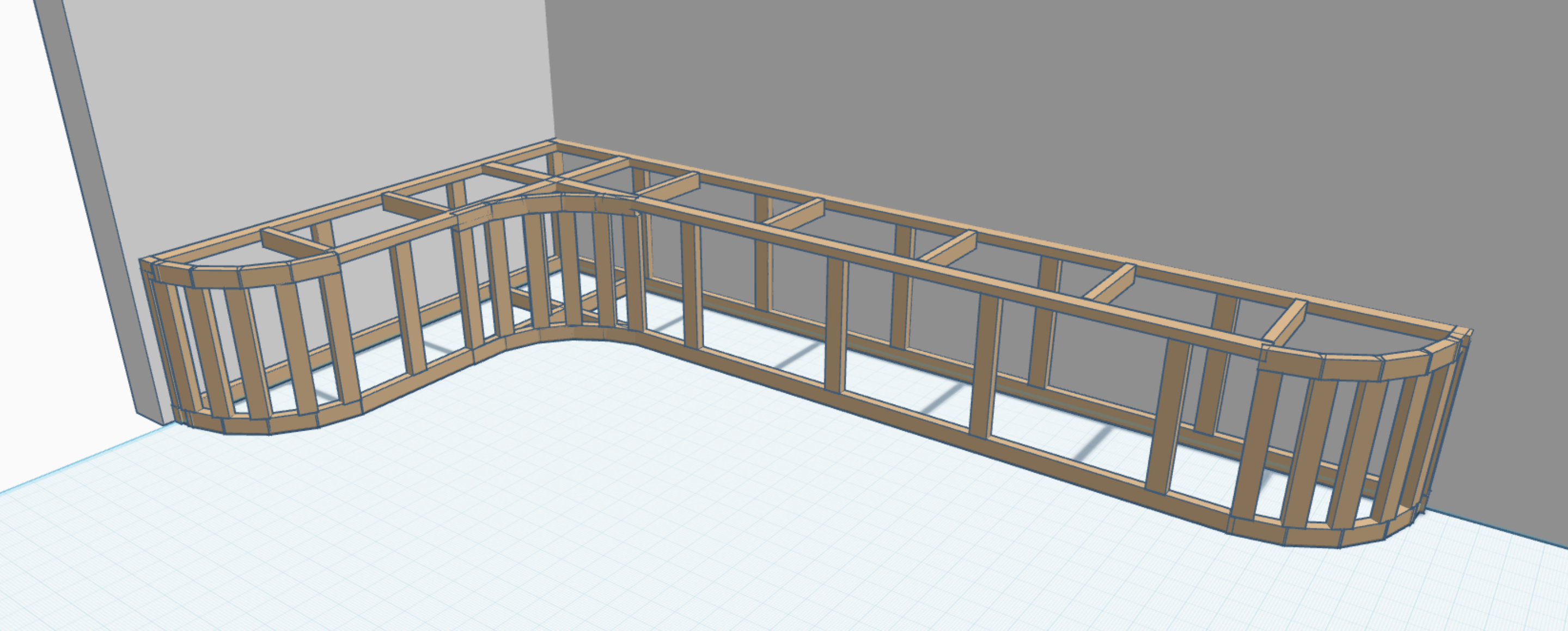

Nothing like adding a few more tools @SarahK1996! It could just about be all done with a drill driver, circular saw and jigsaw. A carpenter could do the work, but I'm pretty confident that you could too. I've created a couple of renderings below to help. It looks a bit complicated, but it's all really just a matter of taking your time and cutting timber to the correct length.
Well I do have all those things!! Even more so better that you have given me confidence legend! I'll have to give it a go, and then nail gun as well? Those renderings are unreal! EXACTLY WHAT I WANT!!!!
Yes, a nail gun would work, but you can also screw everything together, @SarahK1996. You're doing an amazing job, and I think a more challenging project like this is well within your skill set.

On the cutting, you're correct that at stores, they'll typically cut timber to fit the length in your vehicle. For this type of project, I feel it would probably be best to take home as long lengths as possible and cut the timber up as needed. For the frame, I wouldn't get too caught up in the measurements. Have some rough ones ready, but then go with the flow. This looks about right here, this place looks like it could use another support there, etc. No one is going to see the frame once it's all enclosed, so it doesn't actually matter what it looks like as long as it's solid and is the shape you're going for.
