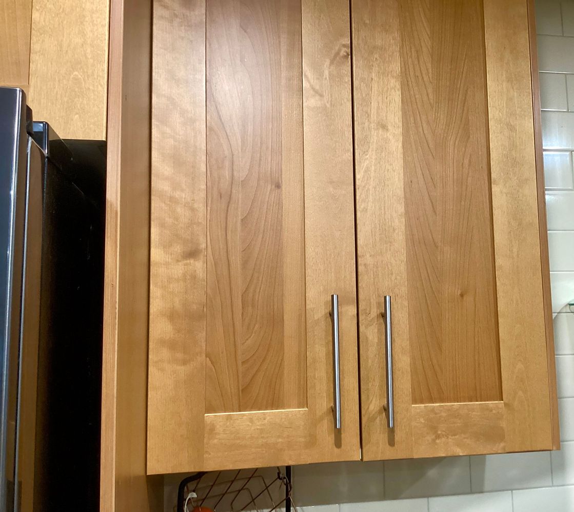

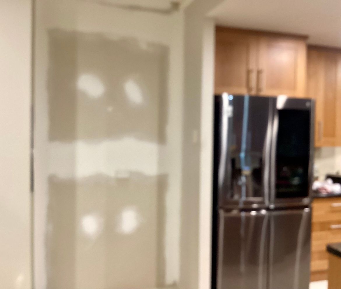

I would like to add a coffee station to my existing kitchen. Kitchen is approx 15 years old and is a kitchen connection kitchen. I’m thinking of buying a couple of raw kitchen doors and then how to match the colorThis is what I am trying to color matchThis is where I want to add to coffee station is where I’m stuck? Would I add wood veneer and try and stain it to match ? Has anyone had any success doing this?

Your idea of getting raw doors to paint was a good idea. However, the Kaboodle raw doors are made of compressed timber fibre and is not made of natural timber and because of this you will not see any timber patterns on it, and it can't be stained to the colour of your current kitchen door.
As a possible alternative, I suggest getting some colour samples of the Kaboodle 450mm Hazelnut V Modern Cabinet Door, the Kaboodle 450mm Spiced Oak Modern Cabinet Door and the Kaboodle 450mm Pinto Bean Modern Cabinet Door from the kitchen department. I propose having a look at these laminate timber finishes and see if one of them blends in or compliments the colour of your current kitchen doors. This would make adding new cabinets to your set a lot easier.
The only other option that comes to mind is to purchase pine panels and see if you can match the stain and sealer that was used on your original doors.
