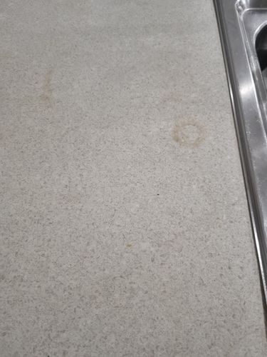

Hi Team,
I am contemplating painting my smallish benchtop in the kitchen. It looks like laminate and would like some tips on how to start please. It tends to stain and I want to repaint it with a different colour.

Painting a laminate benchtop can be a great way to refresh your kitchen without the cost of a full replacement. Preparation is key to getting a good result. Start by giving the surface a thorough clean using Sugar Soap to remove any grease, grime or residues that could affect adhesion. Once it’s clean and dry, lightly sand the surface with 240-grit sandpaper to scuff up the glossy finish—this helps the primer stick better.
Make sure to use a primer that’s designed for laminate surfaces, such as the Renovation Range Primer, which is suitable for benchtops. Once primed, apply your chosen topcoat from the same range. When painting, work in manageable sections and avoid going back over areas that have already started to dry, as this can cause dragging and uneven texture. It’s best to let each coat dry fully before deciding if you need to touch up.
You’ll also want to allow plenty of curing time before using the benchtop again to make sure the finish is durable.
