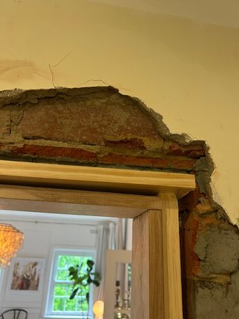

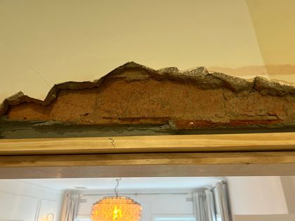

We had a builder cut open a brick wall to create an opening in our house. The render surrounding the opening has come away and we need to patch this so we can apply archives. What would you suggest we use to patch this up? I've purchased this product already Dingo Mortar mix https://www.bunnings.com.au/dingo-10kg-mortar-mix_p0760516?srsltid=AfmBOorJbb6CnDdSy0JngNueClzqnhzkDd3pKCSeRpt8f5Xgyry6mx3v
Is this what we should be using, or do you think there is something better or even premixed? Thanks any tips would be so helpful!

I suggest using Dingo 10KG Structural Mortar Repair Bag as it is designed for vertical application as well. Make sure to follow the mixing instructions as adding too much water will make the mix too slurry.
Here is a handy step-by-step guide: How To Render.
Please remember to wear personal protection such as gloves, goggles and a mask when working on your repair job.
