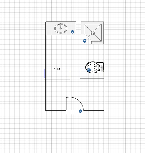

Hi @mike1360 It would help to see a sketch plan with the current layout and dimensions to see what if other issues may need to be considered for the dividing wall. Ideally a cavity slider/s will mean you could possibly make the WIR deeper without the need to allow for a swinging door. The deeper space will also provide more forgiveness with any moisture concerns.
WIR's, are typically in the middle not at the end of a walk through configuration for functionality and as what @EricL mentioned with regards to potential retained moisture and stuffiness. @Dave-1 suggestions of some form of weather-shield would definitely help as would the use of additional stronger exhaust fans. But these would need to be timer switched so they remain on for x-min after use of the shower. All 2-3 could be connected together. If going cavity sliders, then additional brushed style strip on edge inside edge of the cavity opening and one under the door itself.Regards, Nailbag
It has an exhaust fan and needs to be upgraded. I think I'll get a few quotes on rearranging my ensuite. I'll have the WIR in the middle, then the ensuite at the back like this
