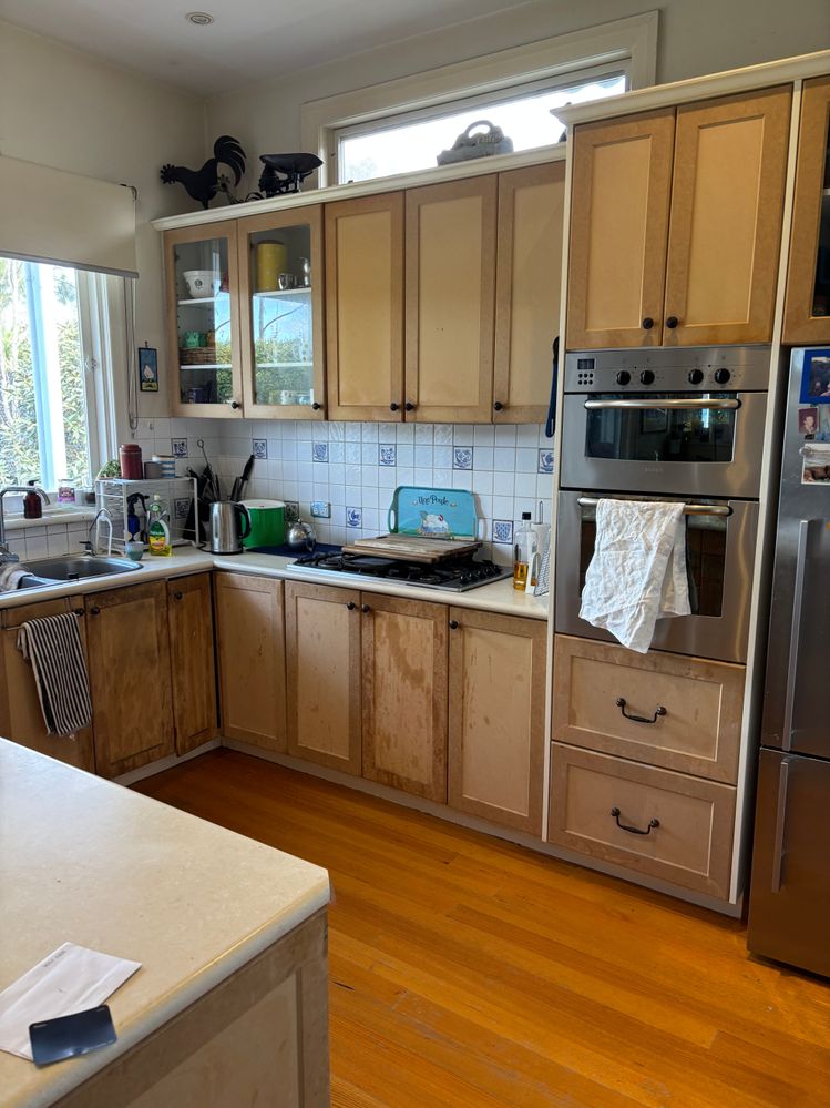

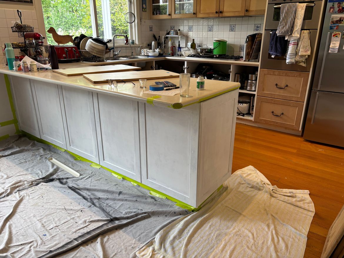

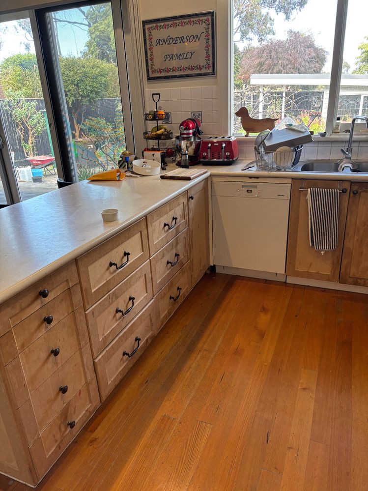

We have a 24yrold vinyl wrap kitchen which has seen better days!
can’t afford a new kitchen, so have removed remaining vinyl wrap (not much as it cracked and peeled a while ago). Have primed doors and will prime and paint the rest. Only issue is the kickboard. It is laminate, and looks terrible.
i was wondering is there a product I can use to glue over the top? As it’s such an awkward space to paint for one fat old lady 🤣IMG_6211.jpegIMG_6046.jpegIMG_6045.jpeg
