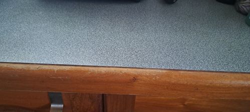

What can I do to revamp  kitchen bench tops without replacing them? I want to cover the top and the wood sides.  What could I do?

Any chance of a little further away photo to help with suggestions of recoveringthe sides? Are you also thinking of the doors?

@Dave-1 has already provided some excellent advice and things to consider. The main one being that it's not a simply matter of just adding material to the top. You simply can't drop thin or thick material over the top as this will affect anything thats already built like the sink, taps and hot plates. These will need to be removed first and then depending on their fitment you may or may not be able to use a more modern laminate. And installing that isn't straight forward either. But there are companies that will refresh the top with this type of product.
Otherwise, remove the current fixtures and then use the old benchtop as a template for a new one. But removing the old benchtop may impact any backsplash tiles etc.
A few wide angle photos will help with more specific advice.

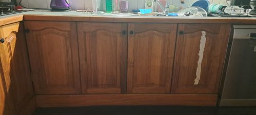

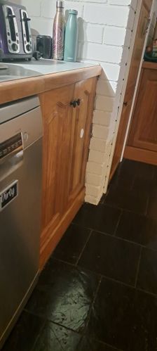

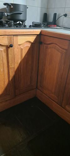

Thank you very much for that advice.  I have included more photos below. I'm planning to paint cupboards and all wood you see in pics white and wanting a marble look benchtops.  I think I may just have to completely replace all benchtops. Just on a tight budget and marble is out of the question!

If you're looking for a temporary solution, you could try Boyle 45cm x 1.5m White Marble Self Adhesive Film. It won't be an incredibly durable surface, but I've seen people use it to get a marble effect on items. However, in the long run, you'd be better off looking to budget towards a marble effect benchtop, which is quite budget-friendly.

White would look good with those door insets and instead of marble I have seen some Laminate Benchtops and in particular Kaboodle 2400 x 900 x 38mm Santolina Benchtop.
Just have a chat with the special orders desk, bring the measurements and an overall photo to make it easier for them and they will be able to help you for sure.
