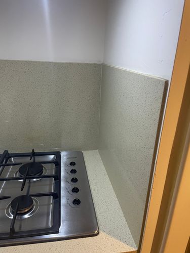

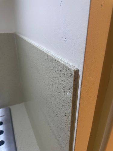

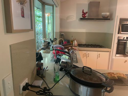

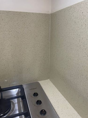

I would like to remove the granite splash back and was wondering if there is a risk of damaging the drywall ? Also I don’t know how much glue was used.
I want to tile a new splash back but I’m not sure if I should do it so some wise advice would be nice 😊 is it worth it ?
Hi @steph7,
There’s a very high chance you’ll damage the plasterboard when removing a granite splashback. You’ll likely need to patch or even replace sections of the wall afterwards. Sometimes, if space allows, you can simply install a cement sheet over the existing plasterboard and glue your tiles onto that, which can save a lot of hassle.
It could definitely be worth the effort if you're after that tiled look — it really comes down to whether you're prepared for a bit of extra wall repair along the way. It's also worth mentioning, although it's less common, that there is a small risk of damaging the benchtop when removing the splashback, so take your time and be cautious if you go ahead.
