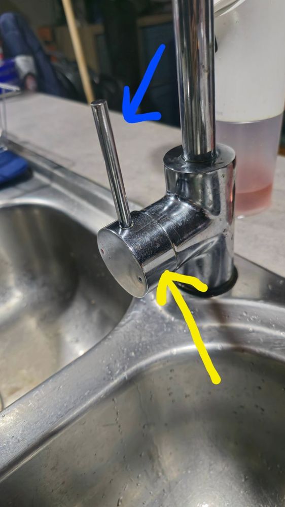

Hoping for some wisdom and expertise in getting this mixer arm/lever loosened and unscrewed/removed so I can change the washer.
I tried wd 40 and also a rubber hand mat to get a grip on the thin lever arm and unscrew counter clockwise but no luck.
It is not held down by a grub either.
Any tips would help. I tried using a rachet but it scratches and still won't grip.
Thanks in advance.

When you say to hold the pliers over the handle do you mean the pliers are used to hold the round cylinder so that does not move? The arm/lever feels very tight so not sure if I hold the cylinder it will still be hard to turn into clockwise. See the image I attached. Is that the handle? Arrow in yellow.

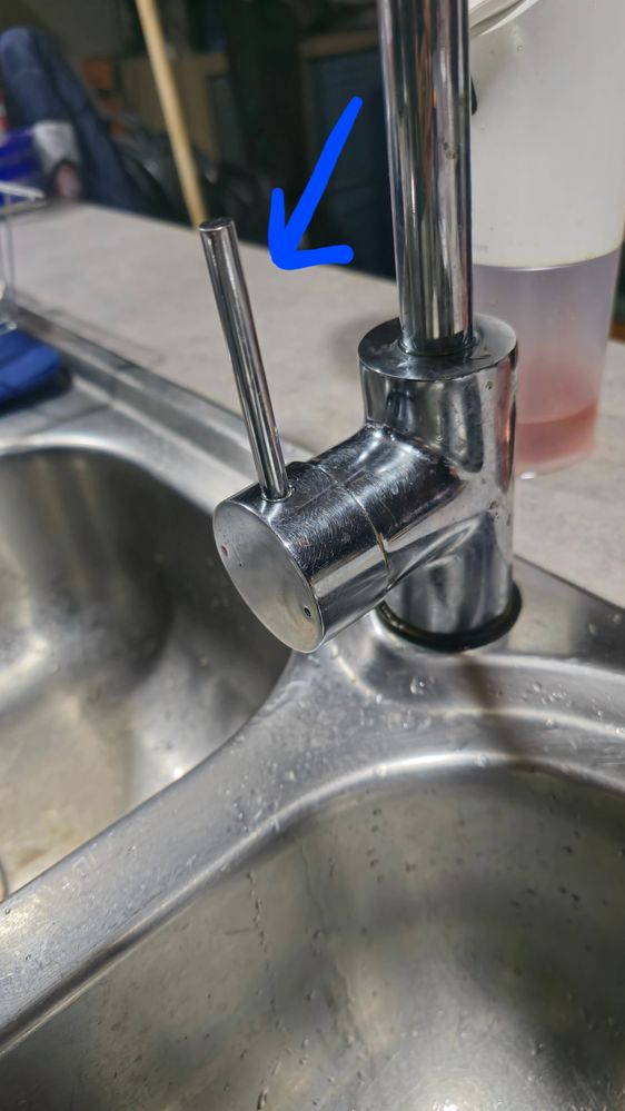

Hi @twilight79
My apologies, I should have said to clamp the pin lever itself. The one where you've placed a blue arrow. The thin handle must come off first before you can get access to the grub screw that is inside the handle body (yellow arrow). I hope that clears that up.
Please note to turn anti clockwise when turning the pin lever (blue arrow).

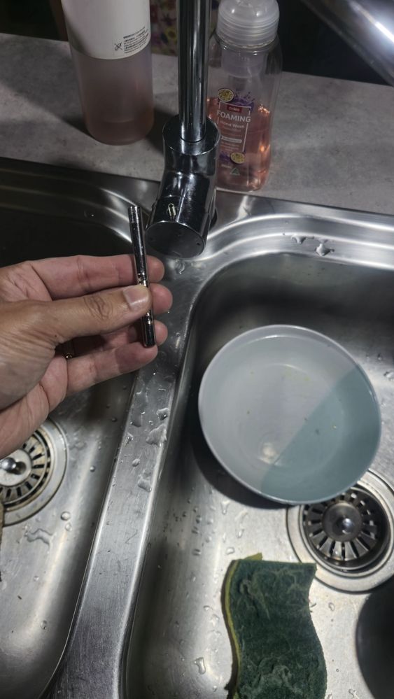

Task completed. Thank you so very much for the insights and guidance. Wouldn't be able to do it without your help.
All up it took 5 minutes to disassemble and reassemble.

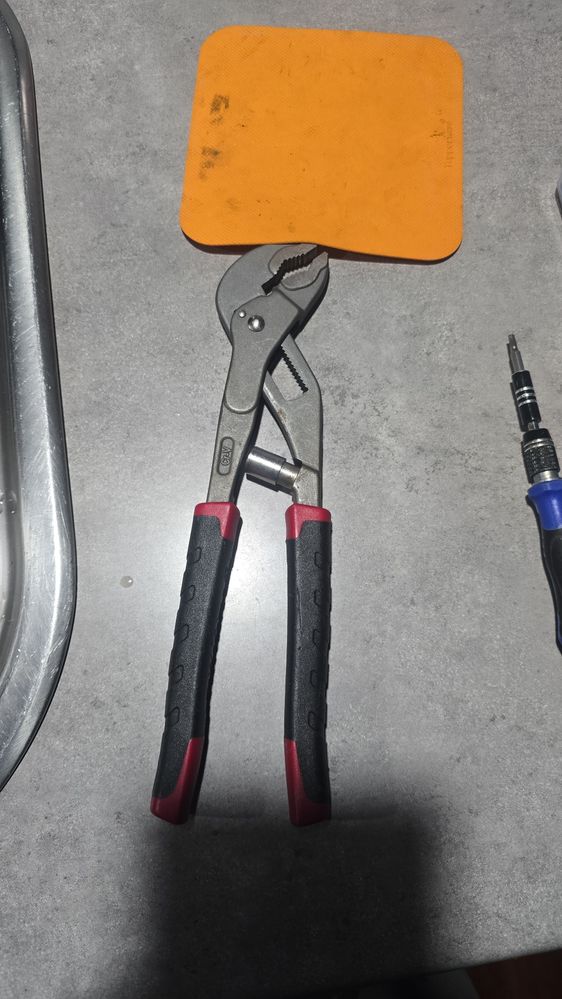

Picture of tools used. Thanks
The lever/handle/pin showed plenty of resistance but gave in finally...
The ceramic flat cartridge 35mm was a perfect fit.
