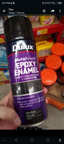

 is this the type of product you are talking about. This is the product that was recommended to me ..

It's great that you've received excellent advice from @Jewelleryrescue. The steel pot scrubber being referred to I believe is the Sabco Professional 70g Stainless Steel Premium Scourer or similar. I agree with the recommendation and that is to wash the dish rack with soap and hot water so that it will be free of grease.
The paint you referred is called the Dulux 300g Metalshield Epoxy Enamel Spray Paint Satin Black. It can be used as is but would be better if you used a primer such as Dulux 300g Metalshield Etch Primer Spraypak Light Grey. Please make sure that the dish drying rack is totally dry before you apply paint.
