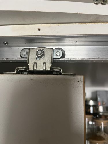

Hi @angelique5,
The process to remove the roller would start with lifting the door up and off the track.
Once the door is off the track, you will have access to the screws that attach the roller to the top of the door. Remove these screws and you will be able to remove the roller.
If there is a specific issue with the roller, I'd need some more details to assist you with repairing it. Are the wheels broken? Is the door not running smoothly? Any details you can provide will help.
If you are looking to replace it, I'd suggest taking the damaged roller in store so you can match it up with a suitable replacement.

Thanks I just got home from work and I’ll try what you said, the door won’t slide as one wheel is wonky on an angle, someone wrecked it or maybe it’s just old but was perfect before I had a person stay here , think , I’ll try to see if I can repair it by maybe tightening it up or something, but I’ll see how I go with removing it , took a while to get access and there’s so many screws I just wasn’t sure how to go about it , appreciate your help and I’ll let you know thanks again
