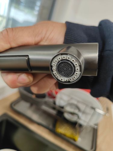

Hi there
I just installed this kitchen tap, but need to attach a swivel aerator. I tried to unscrew this tap head, but seems it is specially designed, requiring som  screw drivers with 4 teeths? Anyone can recommend a special tool to unscrew it?
Thanks
Chen
Re: How to remove this kitchen tap head?
Hello @ChenKellyville
Thanks for sharing your question about your kitchen tap head. Since your tap is brand new, there should be a little plastic bag with accessories in it. In the accessories bag is a plastic key with a circular shape to it. I've placed an image below for you to get an idea of what it might look like. This key will allow you to remove the aerator from the tap spout. However, please note that the aerator might be non-standard, I suggest keeping the aerator in your cutlery drawer and testing your swivel aerator first to make sure it fits.
