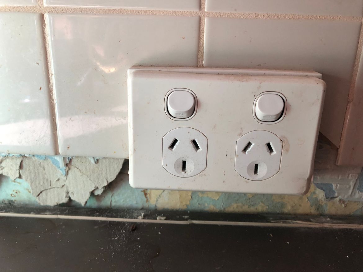

These splashback tiles are stuck on plasterboard, which is stuck on cement. We had a tradie remove the bottom layer of tiles (floor relevelling, long story). We want to retile, but how to remove the rest of this board safely? Do I need an electrician?This is upside down

Easy answer is yes you will need an electrician to remove and terminatate the wires safely so you can remove the rest of the tiles. They also may be able to suggest either new locations for the power point in your build or other perspectives for when you redo the wall. But temporay termination is probarly the wisest.
I have found up to three layers of tiles underneath my powerpoints and not all powerpoints are terminated as they should be (exposed wire at the back) So it can become a problem.
Are there other powerpoints you need removing also? and are you installing more then the one back in?
Ive always ended up having to remove the plasterboard as the tiles are stuck solidly to it 😕

It's great that you've received excellent advice from @Dave-1. In the interest of health and safety, I suggest engaging the services of a registered electrician to temporarily disable your power point. You'll then be able to carry out all your renovation safe in the knowledge that the power point has been turned off.
