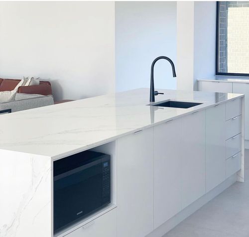

Hello! I am thinking of replacing my kitchen cabinets’ handles to just a more minimal and streamlined handles (i have attached photos of my current kitchen and a photo of the handle im after). My question is, how do i cover the holes of where the handles were screwed? It is a white high gloss finish formica.

Is your cabinetry new, or is this an older picture? You should be aware that filling all those holes in new cabinetry could result in a subpar finish. You're likely not going to be able to fill the holes and touch up just the holes; you'd need to re-paint the entire fronts of the doors. Painted cabinets are never quite as high a quality finish as directly from the manufacturer. If this were older cabinetry, I'd have no concerns with you painting it as the results would warrant the effort.
To cover your current holes, you need to fill them and then sand the filler back to be perfectly smooth. You'd then undercoat the filled areas and coat the door front with cabinetry paint.
I know you're set on more streamlined handles, but there are other options to consider. Your current handles are a little outdated, and trends have moved on. Have you considered swapping them for something in black or brass? If you can find an alternative with the exact sized hole placement, you could improve the look of the handles in a couple of hours. With more on-trend handles, matching black or brass tapware and a new stone-look benchtop, you'd have a really snazzy-looking kitchen.
