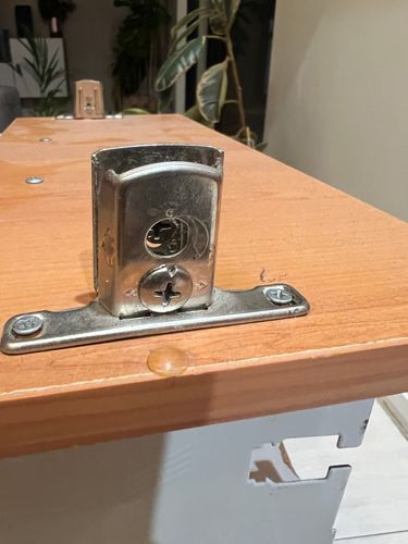

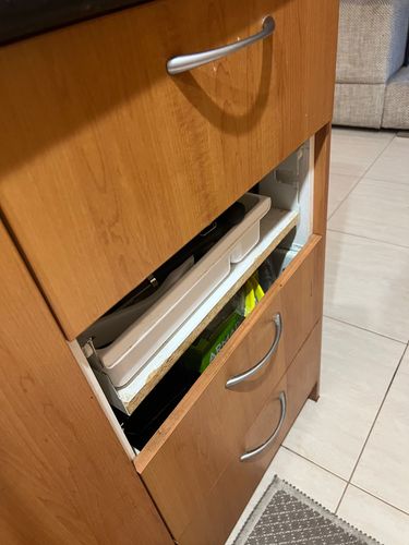

Hi
can some please help me identify the parts I need to repair this kitchen cabinetry and recommend where I can source parts?
Thank you
Re: kitchen Cabinetry Parts
Hello @Joeker
The only drawer bracket in the store that is close to what you have is the Blum Front Fixing Bracket for METABOX Drawer Slide. I'm not sure if its compatible with your metal sided drawers. However, your current drawer brackets appear to be in repairable condition, its just been bent out of shape due to the application of unintended force. I recommend removing the damaged one and see if you can bend it back into shape using pliers and using the fixed one as a reference.
One other option is to use small angle brackets and screw directly into the timber front and the steel side.
