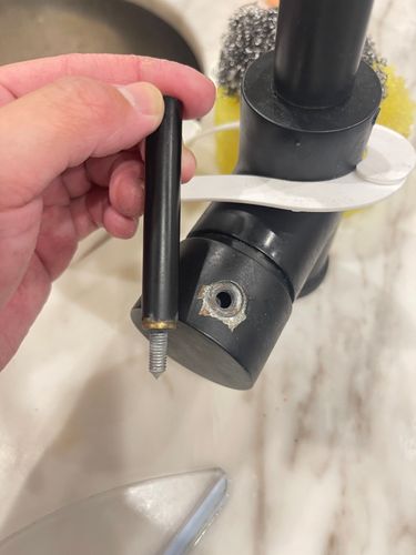

Hello, I'd like to fox this one. It seems like I lost something that could tighten the handle. Any thing recommend, its urgent. Thank you so much!

Is the issue that the tap handle won't screw back in?
If you shine a light down into the hole, can you see a thread at all?
If so, then you may need to rotate the tap body, so the outside hole that the handle goes into lines up with the internal thread.
If this is not the issue, perhaps you are looking for a tool to help tighten the handle. If so, then you can use some multigrips with a cloth to cover the tap handle to protect it from scratches.
If the issue is something else, please let me know so I can assist further.

What if I lost the thread inside, can I buy thread at Bunning or what do you recommend? Thank you.

Hello @Mokumajie
I think the threads for the actual handle have worn away. Do you know the make and model of your kitchen tap? It might be possible to get a spare handle for the tap. At this point in time, if the pin handle does not screw back into the round circular part of the handle, I can only suggest replacing it.

Do you have a thread that I can buy to try to screw them back together. I think it is the Mondella Resonance, is there any spare handle for the tap? Thank you.

Hello @Mokumajie
What I mean by thread is the cutout channel inside the circular part of the circular handle. It can't be purchased as it is a part of your handle. I suggest bringing your handle to the closest store in your location and proceeding to the special orders desk. Please show them the handle and ask them for a quote on how much a spare complete handle will cost. If you are satisfied with the quote, you can instruct the team to order the spare parts for you.
