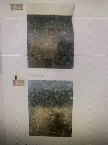

hi all,
Can yoh please advice me how to fix up this tiny burnt marks in the kitchen benchtop. Sorry for the image clarity. It was shared by agent.

Thank you for sharing your question about repairing your kitchen benchtop. From the pictures you've posted it looks like it is a laminated benchtop. Would it be possible for you to post one more photo of the damaged area? Looking at the ones you've posted, it is difficult to tell how bad the burn mark is and if the top part has been stripped off.
If it is a laminated surface, I can only suggest a temporary patch to cover the area that has been peeled off. It is generally a combination of using a multipurpose patch such as Parfix 500g Ready To Use Multipurpose Filler. Once the filler cures, the surface is then covered with touch up paint that is close to your benchtops colour. If put in properly the repair should blend in nicely. Just be aware that the paint will eventually fade, or the filler will crack due to everyday use.

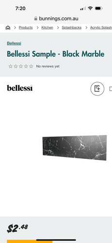

Hi @Ilakiyadevi , if this is a laminate top, try getting a sample laminate from Bunnings then cut the damaged area out into a square shape then trim the sample piece to fit the cut out, you can then glue in place with laminate adhesive, I am not sure if Bunnings have laminate samples, @EricL @might be able to assist.
I found this site that give free samples.

I definently want to see a better photo of how deep that hole is? Like @EricL id suggest to fill the hole and colour it to match. With the bench being dark the colour nmatching should blend pretty nicely.
