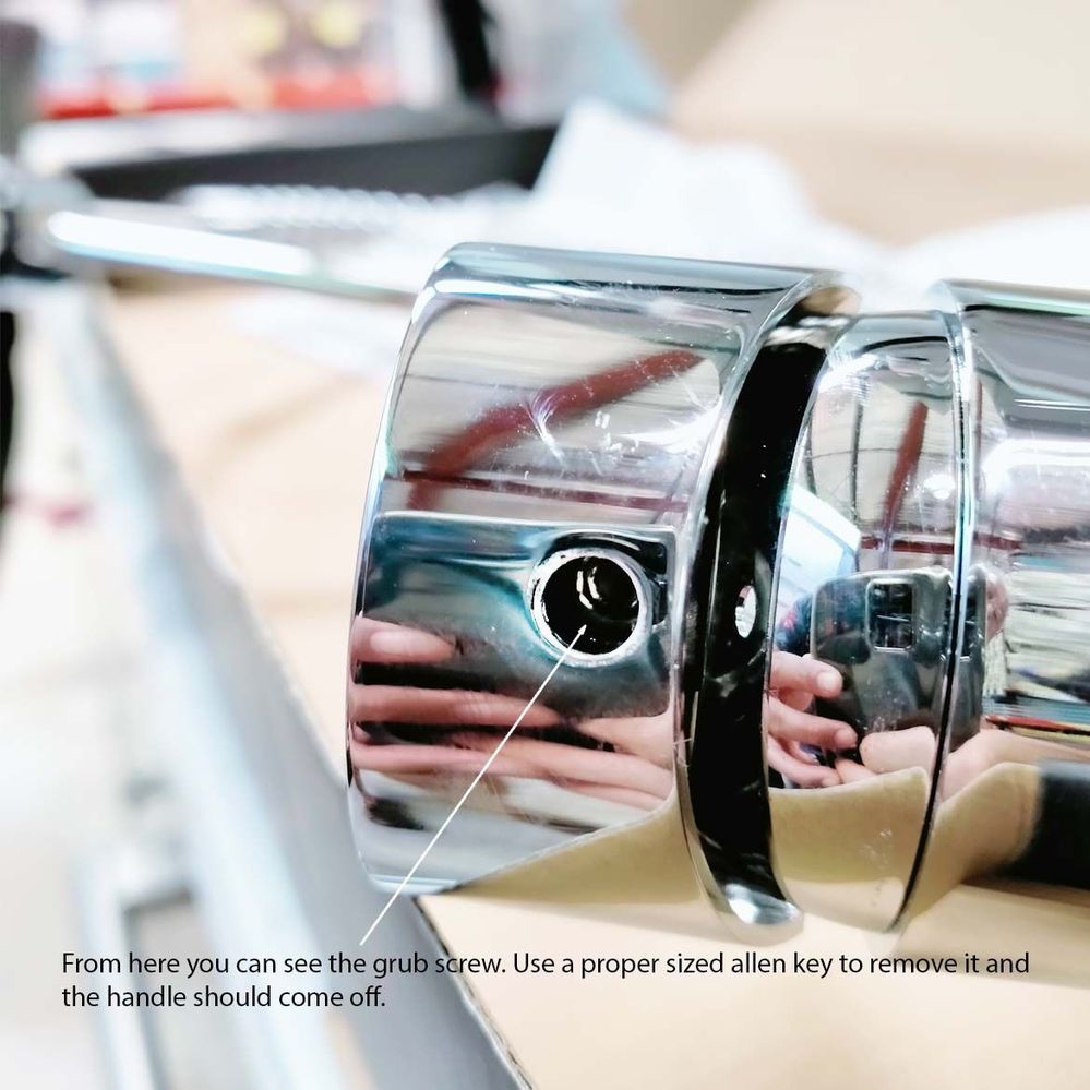

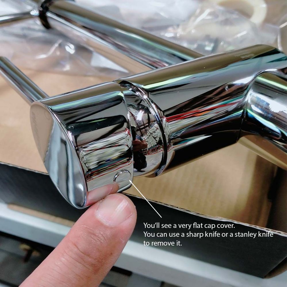

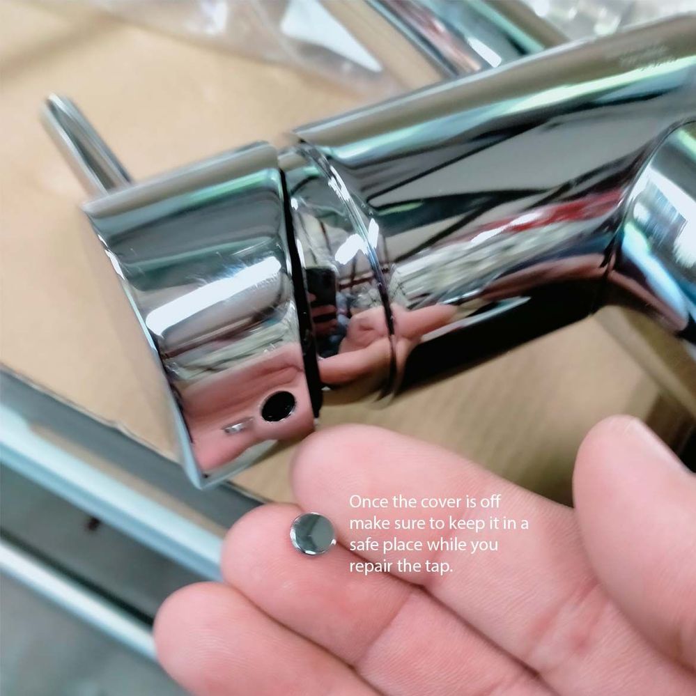

Hello @MarcParkes
The location of the access point for the grub screw is very well hidden. Underneath the handle, you'll find a silver cover cap very well moulded to the body of the tap handle. Directly beneath the handle on the other side is the access point. The cover has to be removed with either a sharp knife or a Stanley knife. Once the cover is off, place it in a safe spot to re-install later on.
You should see the grub screw inside the hole. You just need a proper sized Allen key to remove the screw and the handle should slide off. The remaining steps are standard. Remove the silver cover shield by rotating it anti-clockwise. Use a shifter to remove the brass locking ring. The cartridge can then be pulled out for replacement.
I suggest bringing the old one to the store for comparison to make sure you're getting the correct one for height and width. The product you're looking for is called the Kinetic Mixer Tap Cartridge. I've placed some images below to give you an idea of where the cover cap is located.

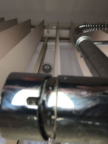

Hello Eric
Thank you to yourself and Mitchell .I think I am back on track . My mixer is an older version with no cap as such . The trick is having the lever in the right spot.
