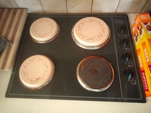

Hello group, I'd like to replace this old Chef hotplate 63.5×51.5cm with perhaps an induction hotplate but impossible to find size , the cutout size is 61.5×49.5cm approx, I don't know what to do am I limited to buying a second hand one same style
, thankyou

If changing the benchtop is out of the budget at the moment, I suggest the following technique. Your current cutout is 615mm x 495mm, I propose installing the Bellini 60cm Induction Cooktop. It requires a cutout of 560mm x 490mm, since you already have 495mm front to back there is no need to make it bigger.
The cutout for the sides is currently 615mm, the new cooktop only requires 560mm. To fix this, I suggest installing pine moulding on both sides of the cut out to the size of 27.5mm x 40mm x 495mm. This will reduce the size of the cutout to 560mm which is what the new cooktop needs. The pine moulding can be painted dark or light that's up to you, but it can serve as a decoration to your new cooktop.
This would be the economical solution for you to change your cooktop without changing your benchtop. When the time comes, and the opportunity presents itself you can then change your benchtop for a new one. I've placed some images below to give you and idea of how it can be done.
Thankyou very much that will work, looks like the old sizing just doesn't exist anymore
