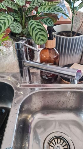

hoping someone can help me. I have googled and can't figure out how to get the tap cover off to replace the cartridge. No hot/ cold indicator to take off or hidden screw. No branding or anything on the tap to help.
Thanks

The first place to look is in the hole that the pin lever handle screws into. Grip the lever and unscrew it counterclockwise. If you have a look in the hole you'll likely find the grubscrew that holds the tap hood on. I've added an image below of a pin lever being removed.
If the grubscrew is not in that hole and you've already searched the body of the tap, then it's probably under the hood. You'll need to turn your water off and lift the lever like you were turning the water on full blast. The grubscrew can sometimes be hidden under the hood.
Please let me know how you go or if you have any questions.
