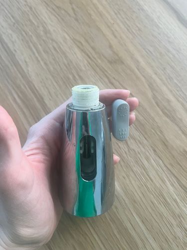

I removed the faucet head from the kitchen tap to clean it because the holes seemed a little blocked and the button to switch between spray and stream was sticking, but now the button won’t go back in. I think I should just replace the faucet head, but there’s no brand name on the tap so I have no idea what to get! Any suggestions?

Alternatively, if you can manage to take some close-up photos of the internal mechanism of the head where the switch fits, as well as the back of the switch itself, our helpful community members may be able to give you guidance on how to reassemble it.
