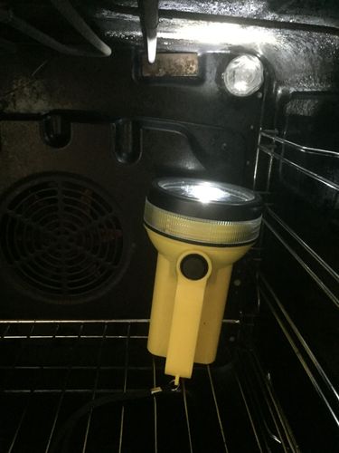

Interior oven light needs replacement
unable to shift the glass cover
Is there a tool or method to help unscrew it?

the main problem is lack of space around the fitting
its poorly designed
