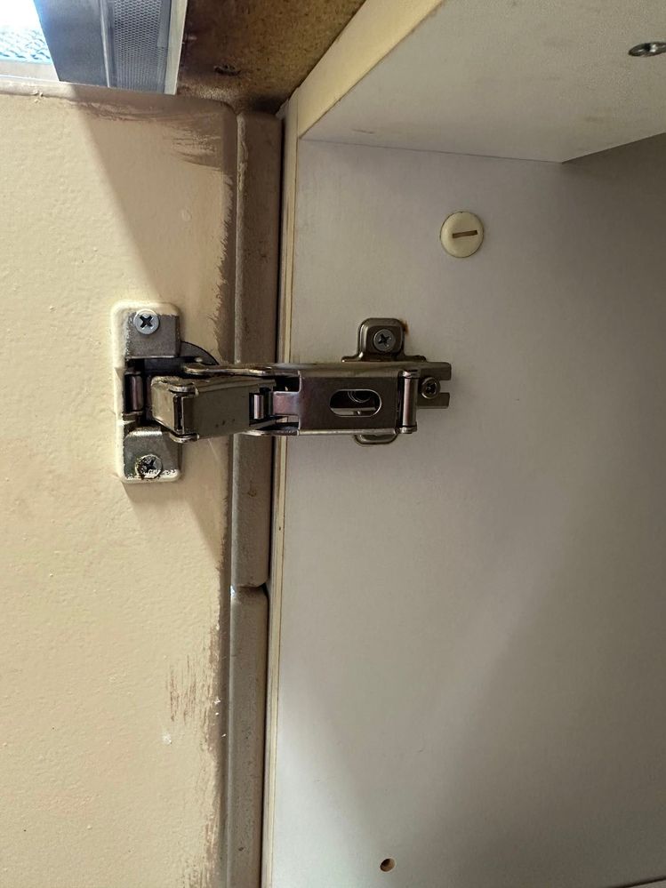

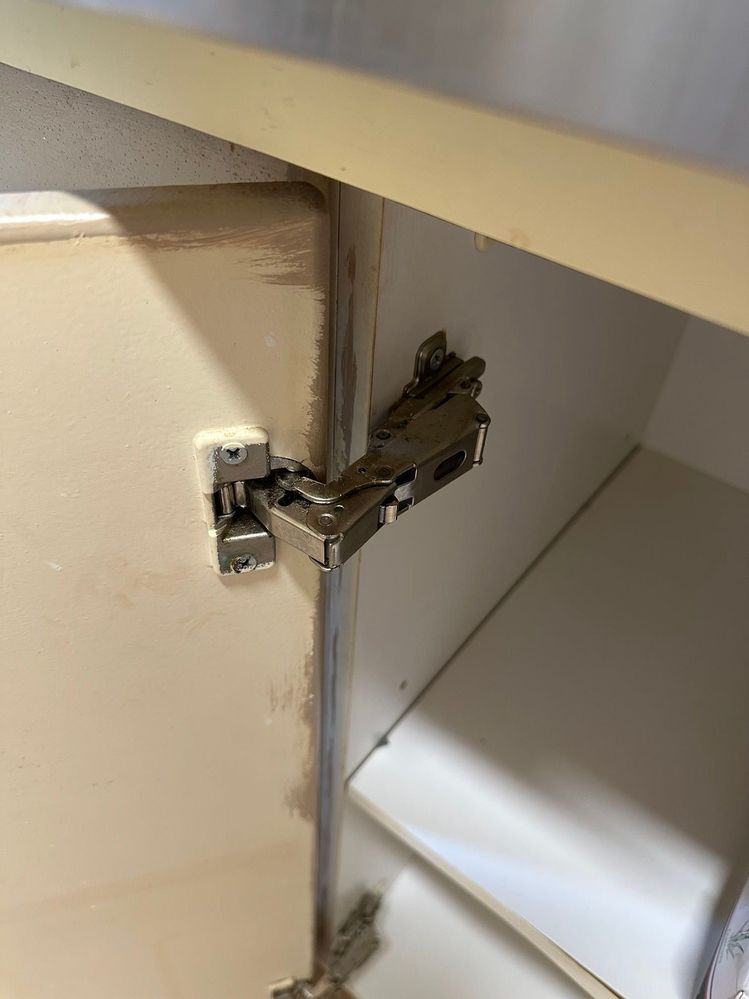

Hi all,
I’m trying to find replacement cabinet hinges and there are so many options like full overlay, half overlay that it makes me confused.
Here are photos of existing hinges - just trying to find the same ones. Or does it not matter if I buy something different?
Thanks,

Hello @fifix
Is this a corner cabinet hinge? If it is, I suggest taking one of the hinges off and comparing it to the Hafele 165° Full Overlay Clip On Hinge - 1 Pair at the store in its folded configuration. These hinges are built to carry a large amount of weight as it technically holds two doors.
