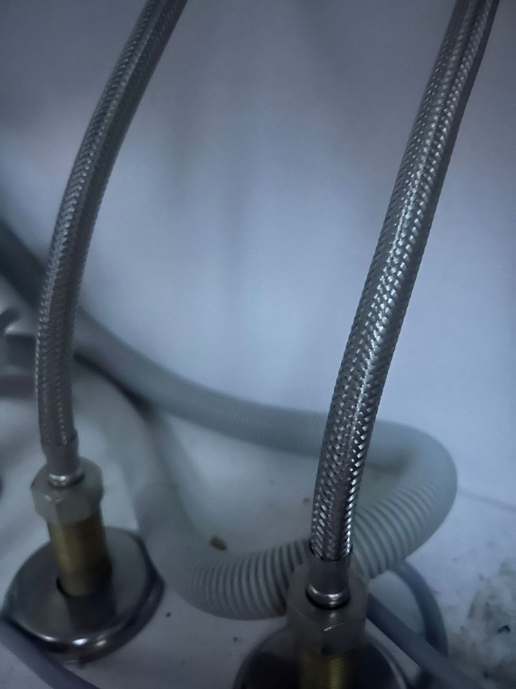

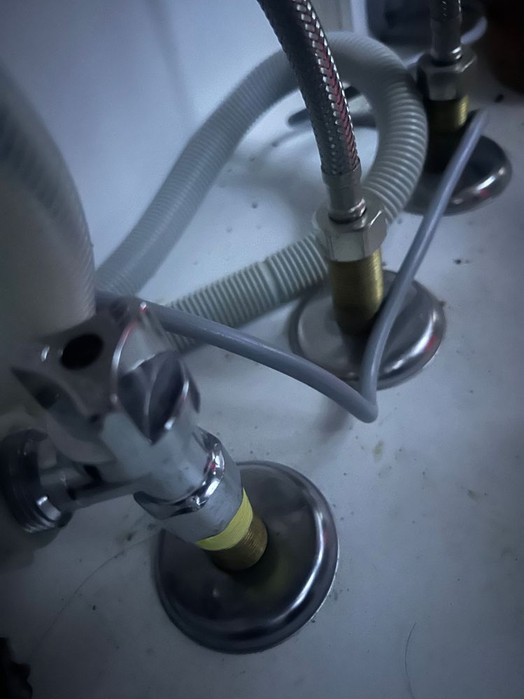

I am trying to replace current kitchen sink mixer with a new pullout tap. I cannot find where to shut off the hot and cold water under the sink.
I have a parallel one with a single inlet and it is going to dishwasher. What am I supposed to do?
Pic attached.

best bet is to turn off water to house at the connection to the property usually where the water meter is. and open a low bath tub hot and cold water so water drains a little so you can work with out a minor flood.

It's great that you've received excellent advice from @Jewelleryrescue. If there is no shut off taps near the hot and cold lines, it will need to be turned off from your mains at the front of the house. I suggest having a look at this guide -How to replace a tap washer. You'll see a picture in step one that shows a water meter and shut off valve.
Please remember to turn on the cold tap to make sure that the water has been shut off.
