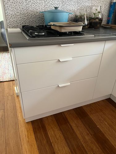

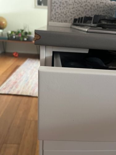

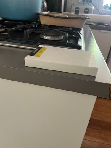

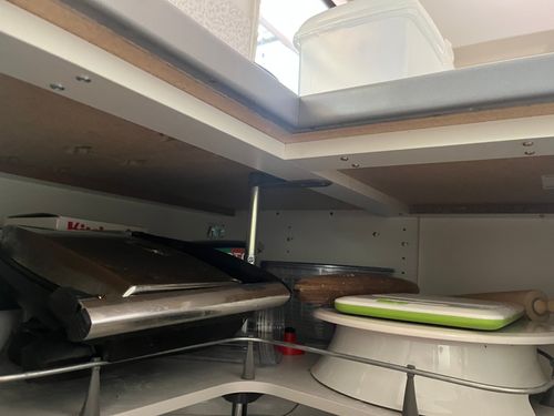

Have uploaded photos
my thought was that the Shadowline would be created but placing filler piece on top of the cabinets as the cabinet sits back from the doors and drawer fronts.

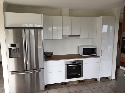

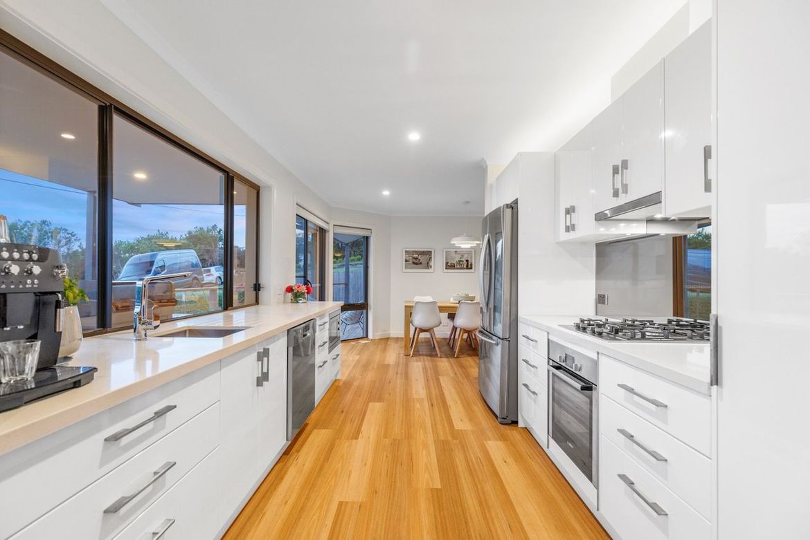

Below are before and after photos to give you some idea. The stone was 20mm with a 40mm facia lip to conceal the substrate and give the illusion of a thicker top.

I should’ve mentioned we are switching to an induction cooktop and range can be raised or lowered as required.
the cooktop change is why we need to raise the cabinet top. With a 20mm stone top (thinner than current laminate) there will not be enough clearance for the drawer below. I’m not sold on the shadowline I just need a solution that looks good and gives me enough clearance for the cooktop.
