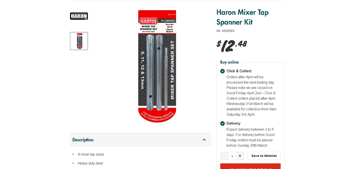

Hello @Rusmer
Welcome to Bunnings Workshop. Is your tap connected with a straight rod and a half moon washer held in with a nut? If it is you need to use a tap spanner kit ( as seen below ) The pipes slot in to one another allowing you to tighten the nut in a confined space. Below is a link of a video of a similar tool being used to tighten the tap assembly. https://www.youtube.com/watch?v=A39XNZACFiE I hope this helps please post should you have any more questions about the tool.

Dear Red,
No, the tap I brought has a plastic base under the sink with a rubber washer under the sink and then a round metal washer the plastic (ca 10cm) tightens onto onto a thread at the base of the tap. It is a Mondella Sink Mixer cadenza7.5L/Min. I tightened the plastic fitting as tightly as I can to the above sink tap assembly but it is difficult to get to and i can not tighten it enough to overcome the friction on the swivelling spout so the whole thing comes loose quickly.
It seems to me that the spout is too tight and does not swivel freely enough..
