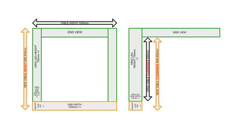

Currently, the clearance underneath the table is 630mm as there are 2 chunky supporting beams running the length of the table. I need to raise the table by >220mm to increase the clearance of to >850mm, to park our Bellini dishwasher and 850mm high LG washing machine underneath. This would mean a totale table height of >970mm. A few extra mm's for good measure would be fine.
Here is an image to help visualise what I mean:
I'd appreciate your guidance for how to go about this, please. I don't know if adding a solid piece the entire width at the floor level or simply an extension piece on each leg would matter; I went with the entire width idea thinking it may maintain strength.

I've added a photo of the table end to my original post now as well. Yep, 220mm is substantial, there's no doubt about that, but I hope there's a way we can do it. I guess at the end of the day, a piece of solid timber which is h220 x w1000 x d120, and use brackets to screw them onto the existing legs. For some reason I had visions of drilling in from the bottom and using mighty long screws, but your idea is far more practical, as long as the sideways (table lengthways movement) strength of the brackets is sufficient. I do like this idea, because friction of the leg on the floor plus bracing equal more strength in my mind, compared to wheels which are just waiting to skate out from underneath you, but I guess they do have brakes. As you rightly point out the wheels would be huge though. I think a solid piece of timber say 225x1000x60 would be easiest?
