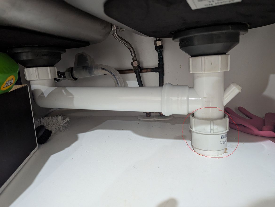

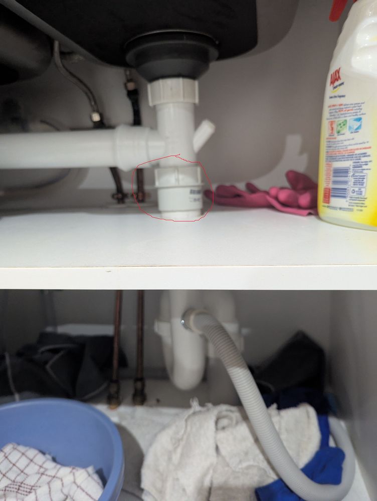

Want to add an undersink water filter and for that I need to remove the shelf under the sink in kitchen. To remove the shelf, I will first need to dismantle the pipe fittings.
The light grey one, as circledPXL_20250718_042443548.jpgPXL_20250718_042458154.jpg in the pics, is very tight. I am afraid if I rotate it in the tightening direction, I might break it. Can you please advise which direction should I rotate it. Looking upwards from the ground surface, clockwise or anti-clockwise.

Generally, screw fittings are loosened by rotating them anticlockwise.
As it is particularly tight, you will want to use a tool such as some multigrip pliers to get a good grasp on the nut. You can wrap the nut in a rag to protect it from damage from the pliers.
