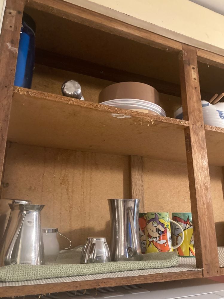

I'm in an old house with a chipboard kitchen and no money to spend on a new one. While i've replaced most of the crumbly cupboards lower down, we have this custom wall cupboard which is fine for now - it just needs to be a different shape.
I want to cut out the chipboard about where you see the plates sitting so that this cupboard is tall, and then put a side in and a door on (clearly there's already been a door at some point in the past). I'll then seal and paint the interior, maybe add some lights in the top, and do something about that horrible bumpy liner stuff (that's a future me problem).
This shelf is already above head height, and its in a low ceiling area (2100) so it's an awkward area to work in - I'll likely be cutting from underneath. I'd like the cut to be as straight as I can get it so that when I add a dividing wall to the right I can reattach the remaining shelf to it to keep it solid. What tools or techniques would be best?

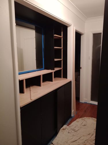

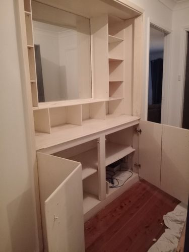

And yep I have been thinking about replacing it by $$$$$ and timing come into play. I have just redone my foyer (almost ready to post the project) But here is a sneak preview...
Before, Particle board all overthe place but still nice.
With no ripping out, placing timber top on top of the existing particle board and overhanging it slightly, plus timber trim on the front of the shelves really brought the foyer up to spec.
Really just an idea on how you could go, I am thinking of upgrading my kitchen that way as well
As to cutting the particle board Id screw a temporary timber strip across on the right between the two supports for the shelf and use a hand saw Bahco 550mm Hardpoint Hand Saw while standing bellow the shelf. When it gets towards the wall, I would switch out and continue with a copping saw Trojan 165mm Coping Saw (Note you may have to do two cuts to get the copping saw in as the handle will be thicker then a blade cut by the handsaw) You could etech the line first using the handsaw by short horizontal strokes across the top of the shelf then gradually tilt the saw so the teeth start biting, make sure you etch the line first as it wake the job easier.
Hmm, doing an etch line on the top would be a good idea. I think I'd have to temporarily take out that vertical timber somehow, it's kind of fiddly at the top and might be a little biscuit join just to be difficult. I'd wanted my dividing wall to be behind the vertical timber, it would simplify everything if I just cut beside what is already there .. but that wouldn't look as good! My old hand saw is a bit of a dud so might have to invest there, but I do have a coping saw and didn't even think of using it. I've used the jigsaw on old particle board in the past, and even with fine blades and going slow it makes a mess, I think I'll stick with hand tools. Your reno looks great - love the timber strip facing boards.
From underneath butt a straight edge against those two frame timbers and pencil a cutting line.
Do the same at the top to help guide the saw.
Use something like a Trojan 300mm Laminate Saw (0191074).
Start with a shallow cut (we need to get past that support) keep going to the handle.
Insert the nose of the saw into the cut on the other side of the support and finish the cutting.
If needed flip the saw over to get going.
I suspect the shelf is simply nailed but if screwed no matter.
Make another 5 or 6 cuts to the back and carefully pry off the sections.
You will need another board/shelf to do the side.
Cheers
