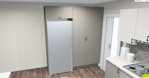

I have a townhouse with a very annoying built-in pantry and fridge space. It is built with stud walls, fixed shelves and a narrow door which make it hard to use the space efficiently. Until recently the door from the garage also opened into the kitchen, clashing with the pantry door (especially annoying if you opened the door when someone was accessing the pantry) but I'm in the process of converting this to a sliding door. My plan is to remove the front and side walls of the pantry and install a modern cabinet pantry with above fridge cabinet, similar to the one I have mocked up in the Kaboodle 3D planner. There is one major challenge which is the main waste water pipe from upstairs comes down at the back corner of the pantry.
I have considered using the Kaboodle pantry cabinets and modify them to suit. One option is to fit a 600mm pantry cabinet on the right side and a 300 or 400mm cabinet on the left. I don't think it would be too difficult to cut spaces top and bottom for the pipe and move the back panel forward, however cutting the shelves down and drilling new holes for the shelf supports would be a pain. I could also use a 900mm cabinet but this means making odd shaped shelves and more complicated joins to fit around the pipe.

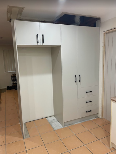

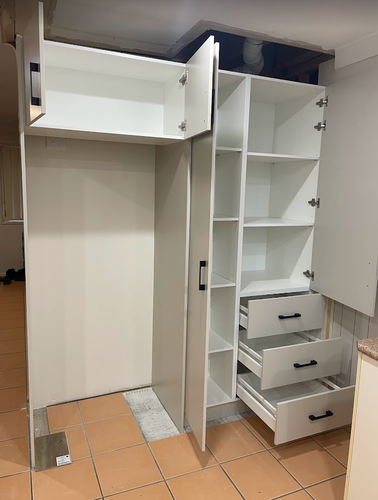

Just an update on the pantry. I ended up going with the custom option which was installed this morning.
The cost was a little under $3300 for the final design with installation.
I considered a few options using Kaboodle cabinets. I certainly could have saved a lot of money if I had gone for the simple option of a 900mm pantry with a cutout for the pipe. However for my preferred option with a thinner, shallow cupboard next to a 600mm pantry added quite a lot to the Kaboodle cost, but a minimal amount to the custom design. I also decided to add drawers to the larger cabinet. To achieve this design with Kaboodle I would have had to make some custom orders and then spend a lot of time making further modifications. After a chat to a kitchen consultant at Bunnings and finding out how long custom orders are taking at the moment, I decided the custom option was worth it in this case. I'm pretty happy with the final result.
I did all the demolition, plastering and painting myself. The next step is to use the materials removed from the original pantry to build a bulkhead above the new cabinets and install cornice. I'm also planning to get some Dulux renovation paint colour matched to the new cabinets and paint the rest of the kitchen.

Thank you very much for the custom pantry update. That combination of 600mm and 300mm custom pantry cabinets looks perfect. No one would ever suspect that you're hiding a drain pipe behind the pantry. Whoever sees it would just be thinking that it is a design feature you've gone for.
Accessibility for repair would have been the same had you gone for the single 900mm pantry, so going for something that you like I think is the best way to go. Will you be putting in a bulkhead to hide the gap between the cabinet and the ceiling?
