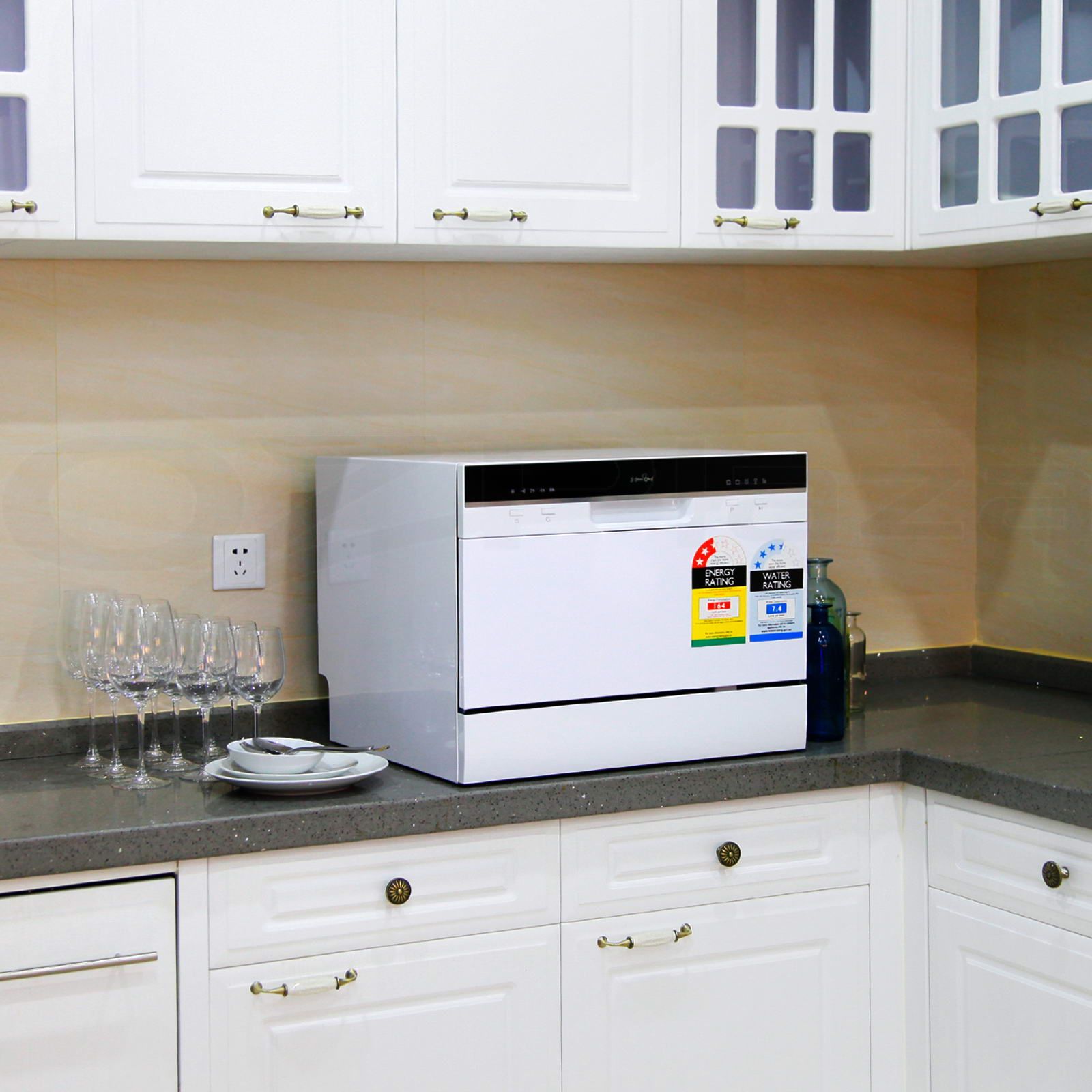

i am just tryng to picture what a benchtop dishwasher is. I dont see why you couldnt place it where the old dishwaher was and by giving you extra storage underneath is actually a really good idea. We all love extra storage.
would you be able to post a photo of this dishwasher?
Place it in the space, if the door opens fine and the water connections are hooked up properly, the main convern is the water waste dishcharge pipe making sure it is installed to the given instructions

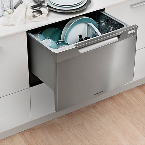

Oh yes I see now, my opinion is I’m not a fan of the benchtop one. It’s small and an eyesore. I would Also recommend the draw dishwasher.
but at 4 times the price the benchtop model is so much cheaper. I am considering this option
single drawer dishwashers are 3-4 times the price

It would be best to touch base with the manufacturer of the product you're looking at to ensure there are no issues with this type of setup. The only concern I have is since they've been designed as an open-air product, enclosing them could cause an overheating or moisture issue. Our Everdure 55cm Silver Countertop Dishwasher can be recessed into cabinetry but can not be run with a closed cabinet door. It's advised not to install a cabinet door as future occupiers might not realise that it needs to remain open during the wash cycle, which can lead to mould issues or machine damage.
