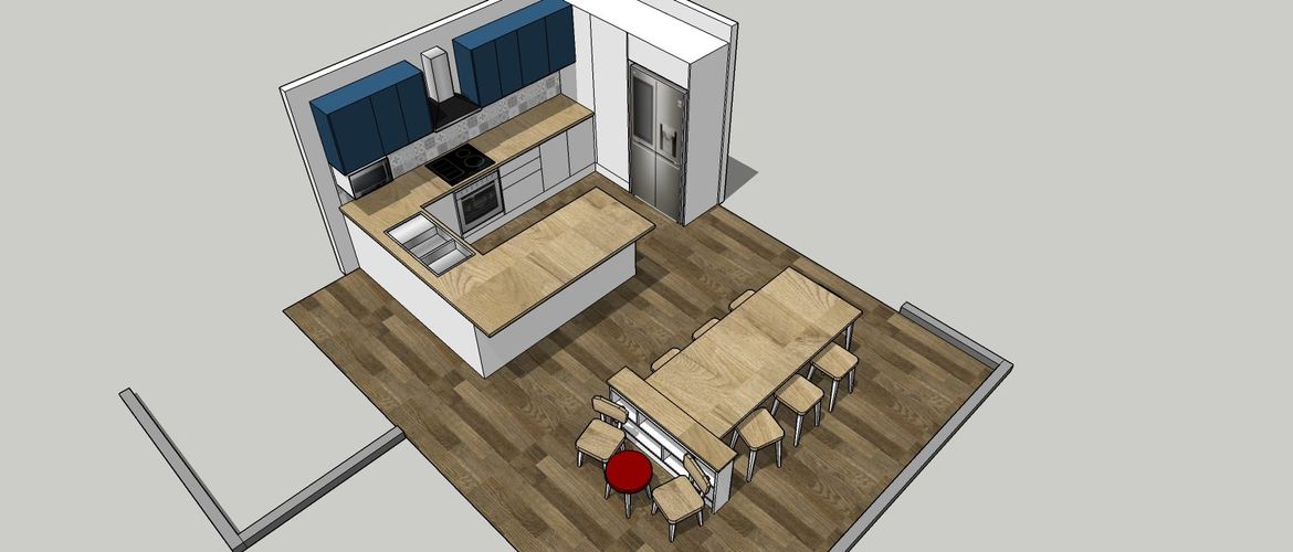

We're currently designing an extension to our house (in Sydney) and are having difficulty finding a great kitchen configuration. We really want a sitting area next to the kitchen so we can have a cuppa and enjoy the backyard view, but that means we have limited options for configuring the kitchen. The only way I've been able to make it work is by putting a corner pantry (ergh!).
Does anyone have any ideas for how we could make it work without a corner pantry?
We have 2 adults and 2 kids in the house, and we like entertaining. We don't want a sink or stove in an island, and we don't really want to encroach any more into the dining space (it's already a little tight).
excuse the rudimentary plans (there a some windows missing haha) but it should give you some idea.

It's great to have you join us and it's fantastic to hear about your house extension project. I've tried moving a few items around and I keep ending back up at the same situation. To not have a corner pantry you'll lose bench space and have an unusual flow to the kitchen. Had you considered not having a traditional pantry and replacing it with cupboard space both above and below the bench?

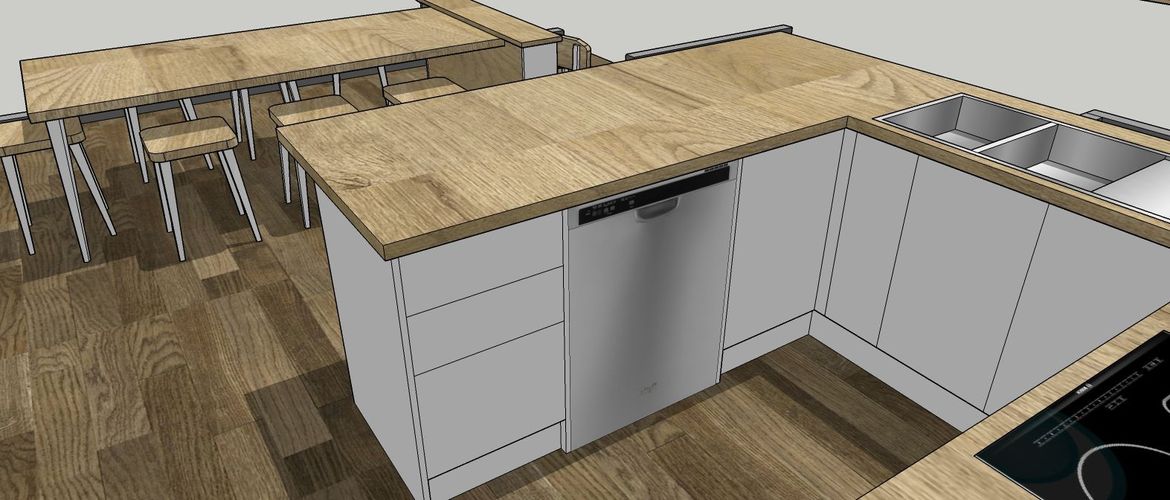

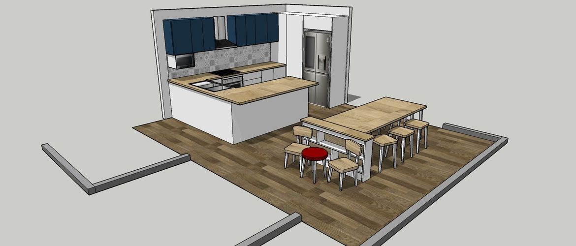

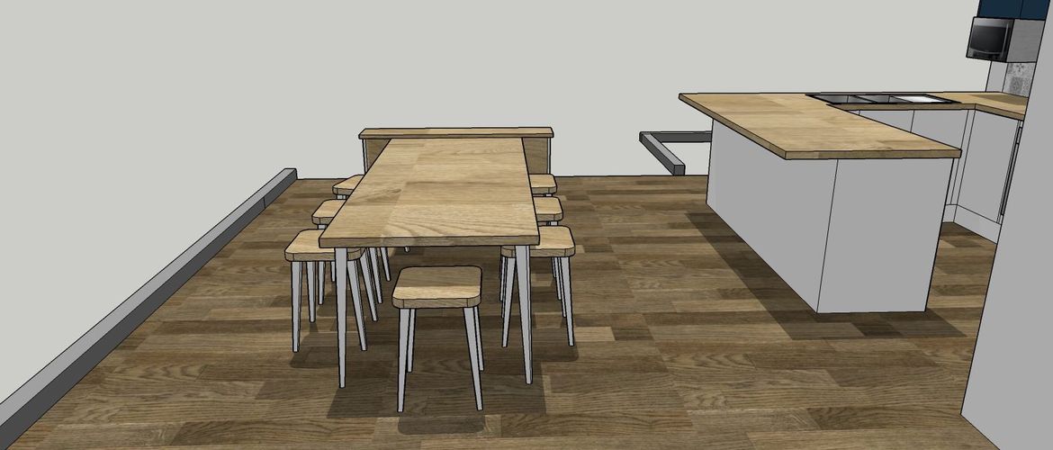

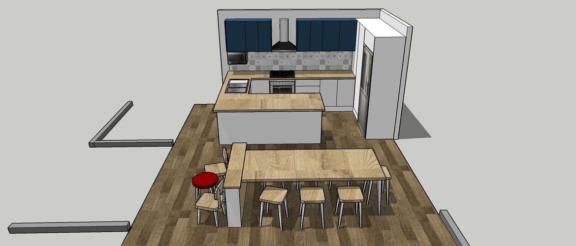

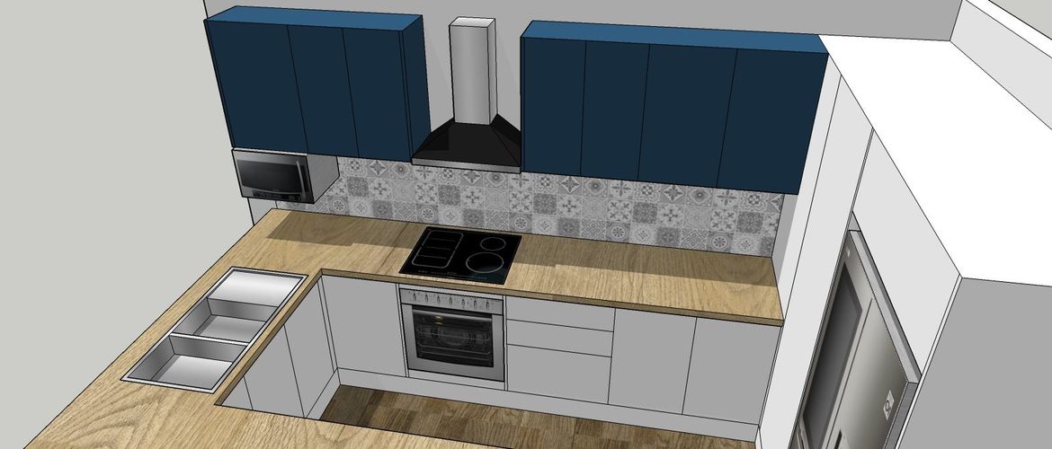

- Use a blind corner pantry to get rid of that bulky look of a corner pantry but still maximize on pantry space use. It gives a much more modern look and does not give you uneven angles in the kitchen.

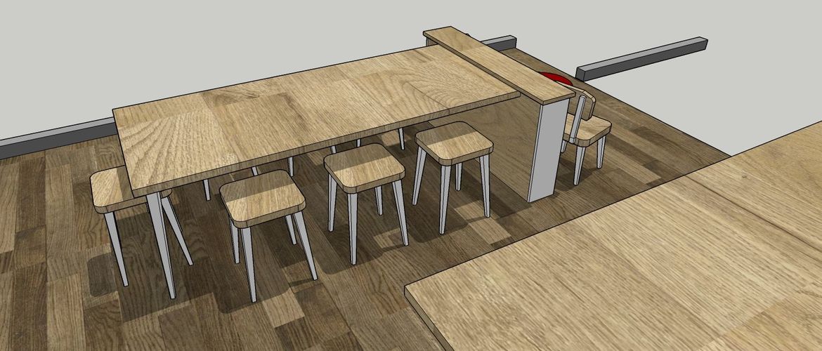

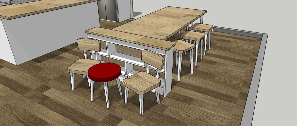

- Use a small book case divider to make the "cuppa" area defined! Because it is your time out spot you get to choose the chairs that go on at the end. You still get at least 7 seats for the long dinner table or you can use a long bench on each side and really have the dinner table packed!

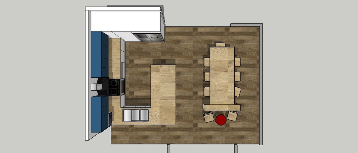

- Using chalk mark out the area of the dinner table and chairs and see if there is enough room to walk around and have the book case at the end with the chairs facing the big backyard sliding doors. You may have to do a DIY on the book case if you can't find any at the stores or gumtree.
- Remember to keep your options open, if the first idea does not work keep trying, this reno only happens once in a great while I suggest getting as many ideas as possible. If you wish to try another idea just drop us a line here on workshop. Goodluck and be safe! This will be a two post series as I've made at least 10 pictures for you.noni1.jpgnoni2.jpgnoni3.jpgnoni4.jpgnoni5.jpgnoni6.jpgnoni7.jpgnoni8.jpg
