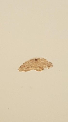

Hello,
I need some advice on a chipped kitchen cupboard door and what product(s) to use to fill and paint.
Standard white kit kitchen (plywood?). Chip is approximately 2cm by 1cm.
Thank-you.

Welcome to the bunnings Workshop community @GD. It's terrific to have you join us and many thanks for your question.
There is a CustomPine 12.5ml White Melamine Mend Paint that would work quite well in this situation. You might like to start by filling the area up with Timbermate 250g White Wood Filler and then sanding it flush with a Trojan 320 Grit Jumbo Sanding Sponge. It would be a good idea to tape off around the damage with masking tape so you don't leave scratch marks in the existing laminate whilst sanding. This will give you the best surface to paint onto as it will be smooth and level with the surrounding laminate.
Please let me know if you need further information or had any questions.
