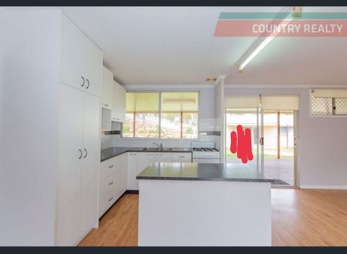

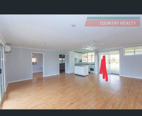

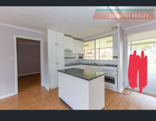

Hi everyone, I have a small kitchen, the kitchen is in one big room that has a lounge and dining area all in the same area, the kitchen doesnt work, and I was thinking of making it more a U or L shape, in the following pictures the red area is where my fridge is, so it's blocking half the sliding door, would love some ideas of how you would change this around, thank you

It certainly looks like whoever designed that kitchen didn't really use one all that often. The doors surrounding it make it quite a tough space to work with. Might I ask where the door next to the pantry leads to?
My first thought would be to move the pantry against window and create parallel benches with one from the pantry to the doorway and the other from where the oven currently is to across from the doorway, while removing the bench where the current sink is. Unfortunately that would involve replumbing the sink and oven (if it is gas) and that could push the budget up, but it would give you two decent length sections of bench and room to use the complete length of both of then. I like the use of parallel benches over u-shape where suitable as u-benches created tight corners that waste good working space. The fridge could go between the two doorways.

Thank you for your input never thought of that as an option, that's great, the door to the left is entrance to a bedroom

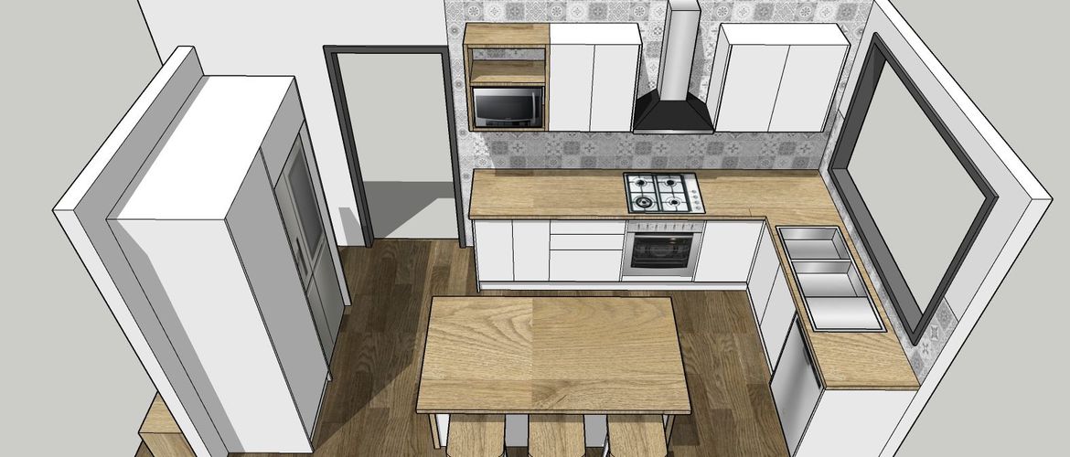

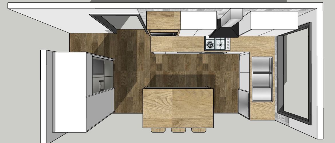

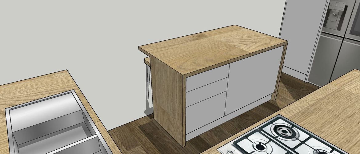

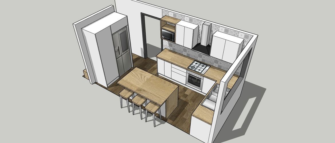

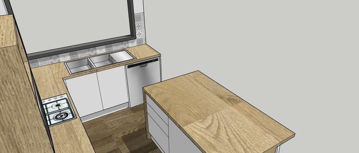

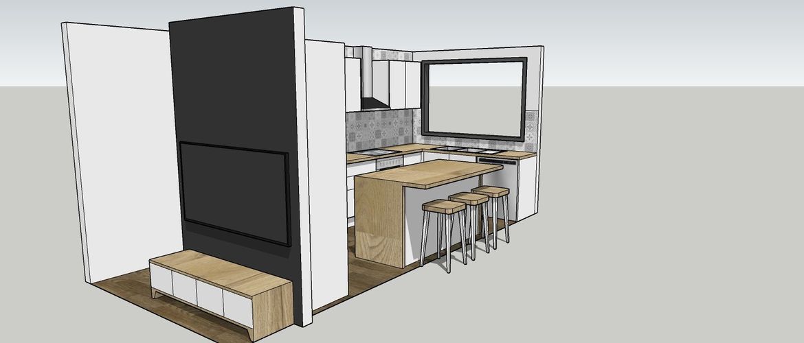

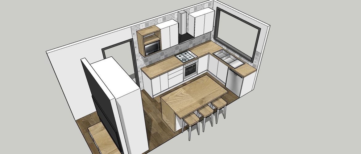

Hello @bobby1985, I'm glad you've received some very informative suggestions from @MitchellMc and @tom_builds about the layout for your kitchen.
I see the former owner has designed the area as an open-plan space. However, the drawback is that it has now left you with very little wall space for tall cabinets. Just to add to the ideas that have been suggested. I propose building a wall for the fridge and pantry cabinets. I've built the wall specifically just for the pantry and fridge. The wall will still allow ambient light to pass through from either side and not completely block off the other side of the room. Please enjoy the pictures and we look forward to seeing your kitchen once it's complete.

This is amazing I just can not thank you all for your help to open up my mind how this can be achieved
