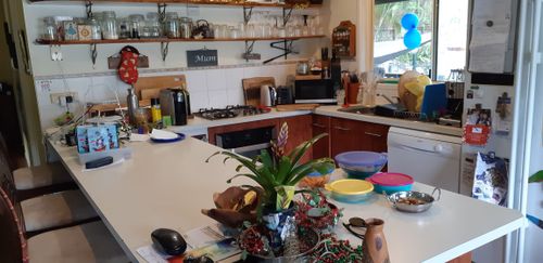

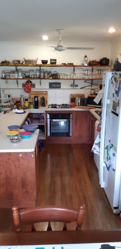

  Kitchen dimensions are 3090mm on long sides, 2770mm along back wall. There is a 1600mm window, 590mm in from the back wall on the right, plus a 900mm space for the fridge. Space between dishwasher/sink and opposite bench top is 1370mm, and 940mm opening to the dining area between fridge and bench top. There is also currently a 190mm breakfast bar overhang.
Was thinking of having an island bench, but don't want to lose cupboard space and bench top space. Currently, have no pantry, but thought about a thin one on the end of the fridge, where there is a 95mm wall, (enclosing the fridge which maybe could be removed and made into a thin pantry) plus 215mm to screen door opening.

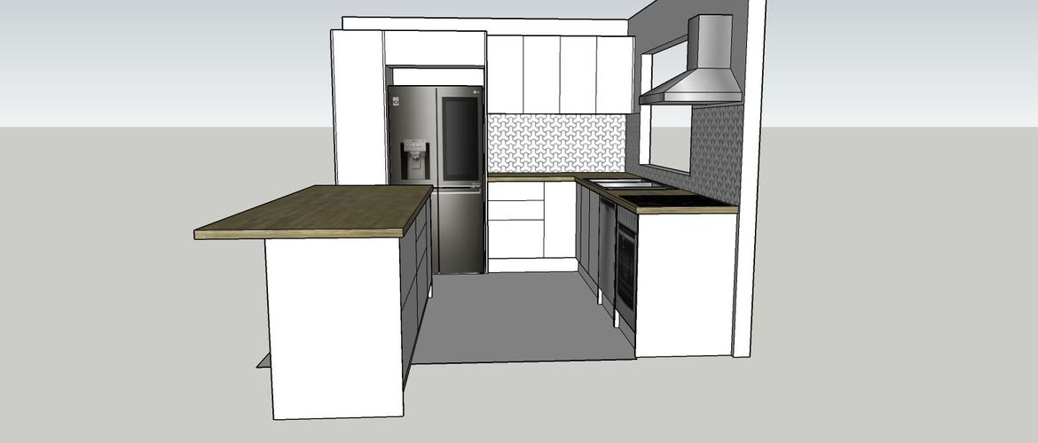

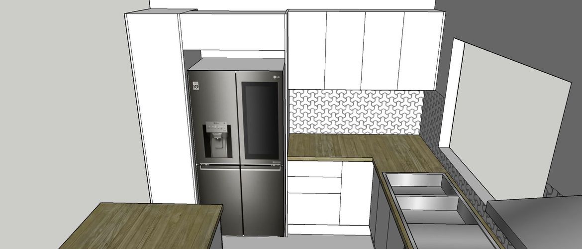

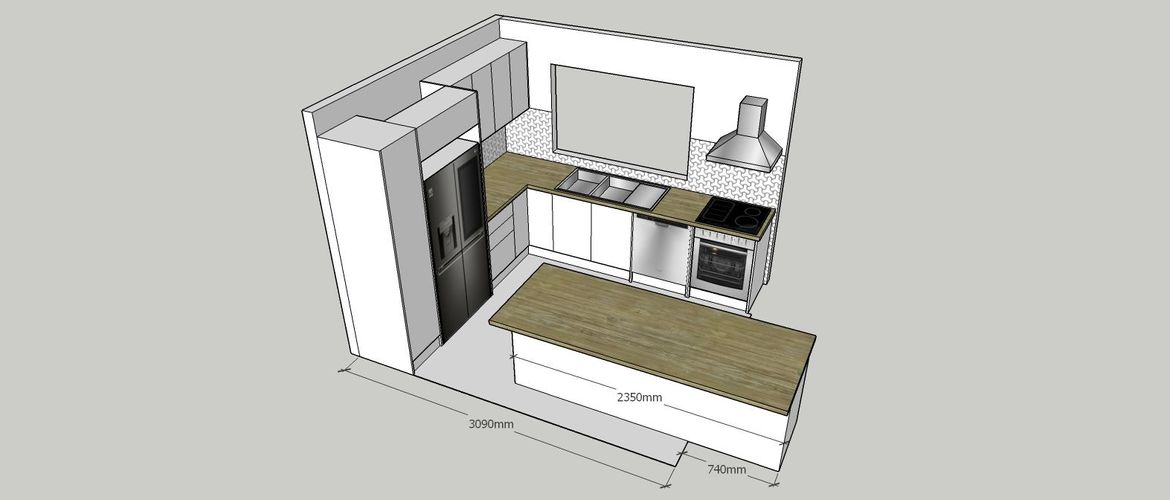

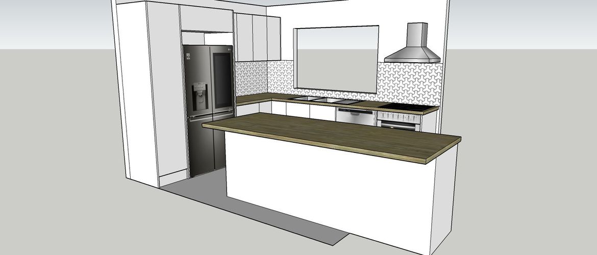

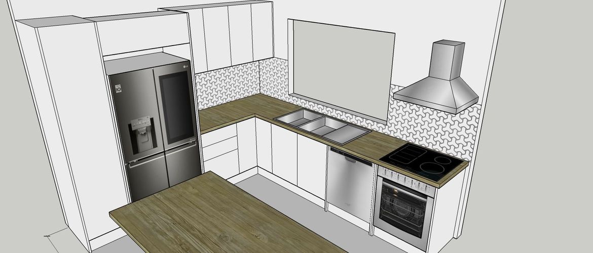

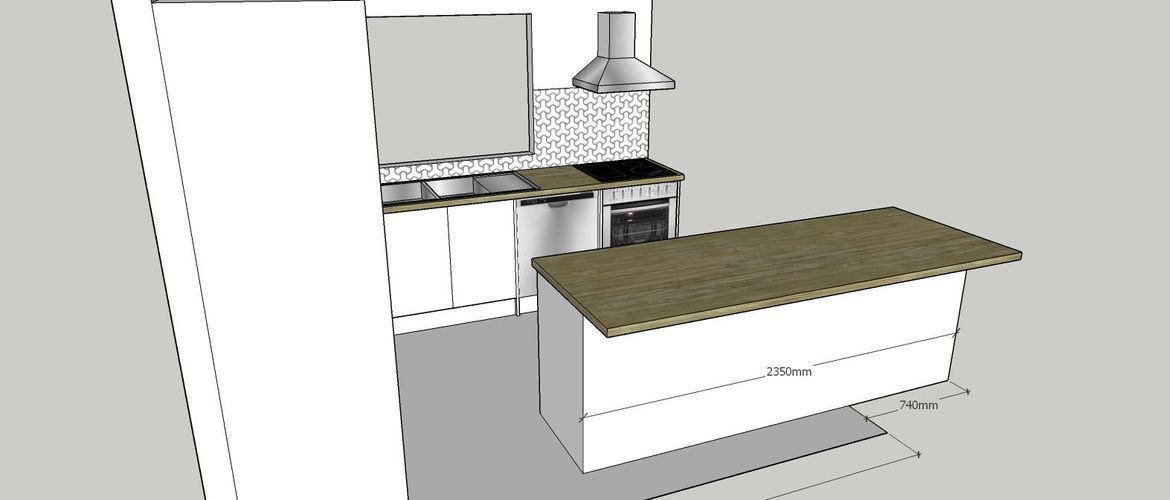

Here are some ideas.

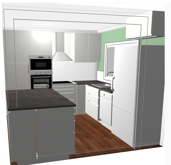

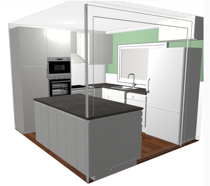

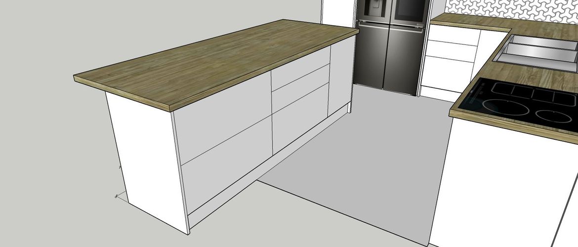

Here's an alternative within the 3090mm x 2770mm space--Redracer's design will fit too if the size of the island is reduced. The software I used is clunkier than Redracer's--it didn't allow me to have 2 open sides so I had to fudge if with "openings" (hence the "door frames"). I couldn't "build" a proper island so have used back-to-back cabinets but without overhang :unhappy:  Island dimension is 1800x1000--that allows approx 690 walk space to the pantry but could be bigger. Removing the wall next to the fridge & replacing it with a wall panel would add 90mm+ (depending on how close it's extended to the screen door) less 16mm for the panel. And software doesn't render the colour very well--cupboard fronts were meant to be gloss white (with built-in pull handles for drawers) & concrete-look laminate for benchtop. Cooktop area is a bit squeezy so the pantry could be reduced from 600 to 400mm to give more space.
