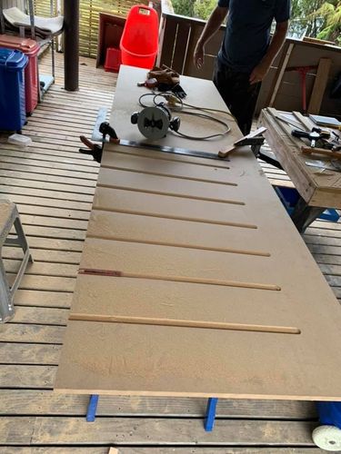

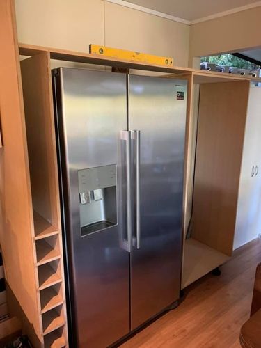

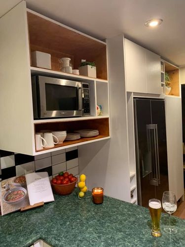

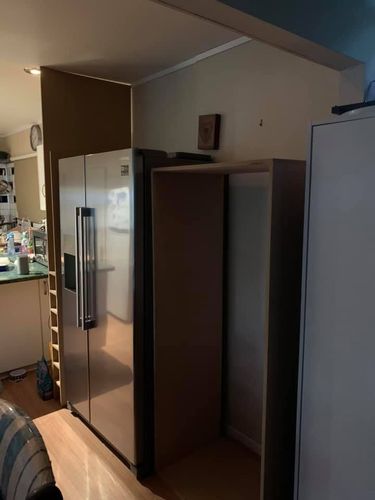

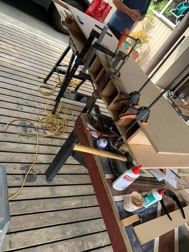

When we bought the house, our kitchen didnt have enough space for our double door fridge so it had to kinda stand in the dining room which I was not to keen on. So we decided to extend the kitchen and dining room into one. I drew up all the plans and measurements. I got a quote to have it all done for me and thought I could do it way cheaper myself. So I gave it a go.
88198447_10158385551949789_1498962016008667136_n.jpg98199387_10158699179669789_6184084794012336128_n.jpg

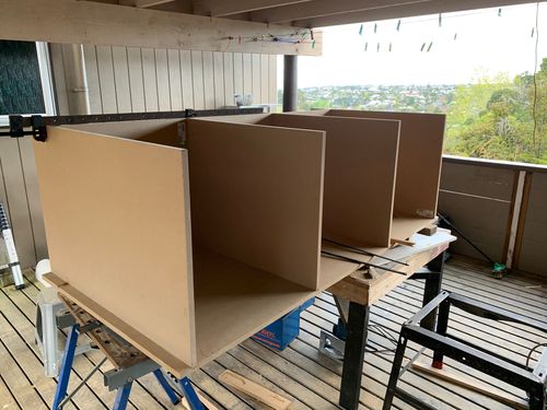

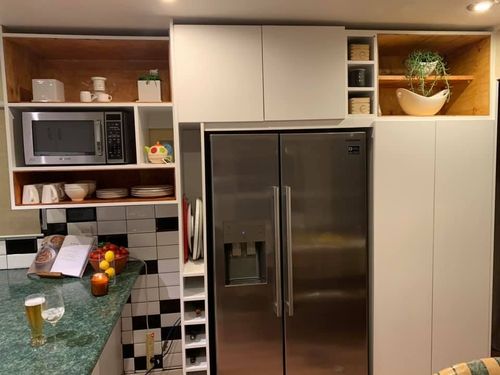

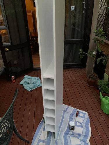

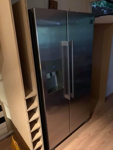

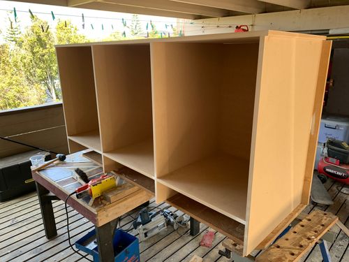

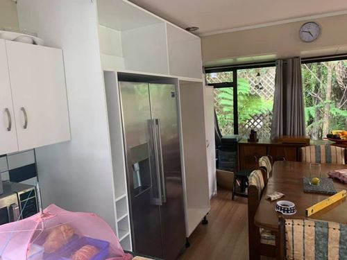

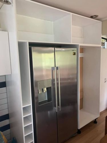

The carcasses are all glued and biscuit jointed. The wine rack is routed grooves in the side panels. Then to move the microwave off the counter I built another carcass which can house the plates and some other goodies too. This saved space on the bench and the cupboards. I lined the open cupboards with some plywood sheets and varnished them, this was to try and break the white a bit. I still didnt like the fridge being outside the kitchen, thats when we decided that the green bench would need to be removed and the island taken out so it flows better.

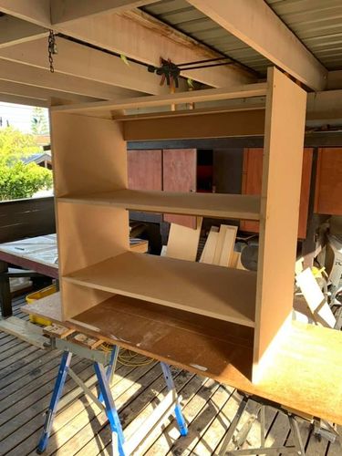

Here are some more pics of the carcass for the microwave and plates etc. Again I did the frame with biscuit joints and glue. The shelves in the middle were routed grooves and glued.

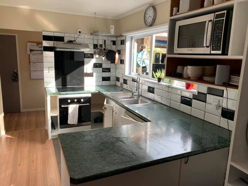

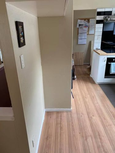

Here is another pic of the old bench with the island. The cupboards and drawers under the island I moved around into the gap next to the wine rack. It all fit quite nicely so that worked out well.

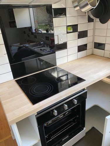

The wood makes the stove stand out quite nicely. This was the hevea (kaboodle) tops I bought at bunnings. This was before treating with Danish oil.

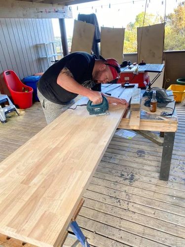

Here is me :smile: cutting out the hole for the sink.

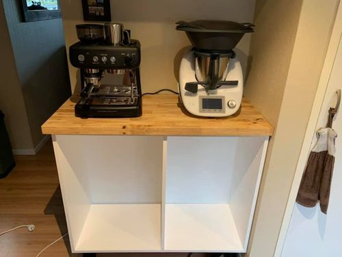

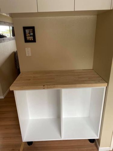

Then the next part which I am currently still doing is adding another bench top and carcass where the small fridge used to be.119020073_10223848494744799_4736256870385231074_n.jpg
Once again this carcass is biscuit jointed and glued together. (18mm mdf). The tops are also hevea, but I got the thinner boards which are 18mm and not 36mm like the other top, I wanted to try double up the edges of the top to make it seem like 36mm tops like the other ones. I cut strips out of the hevea board and glued them to the underside. At the back I am just doubling it up with 18mm mdf off cuts because no one can see it there. I did this as an experiment in preparation for another project coming down the line soon for a new island.
Once again, I think the wooden bench tops look really good with the appliances on them.

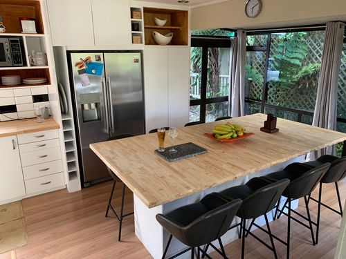

So our kitchen reno continues. I did some work on the island this weekend. It replaces a dining room table and we are trying to bring the kitchen and dining room together in a comfortable and inviting way.

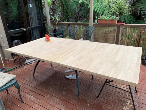

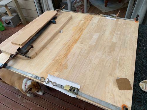

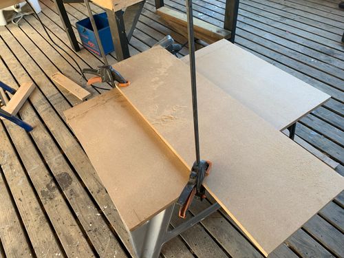

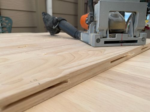

We were after a over sized island, this one is 2.4m x 1.2m. I bought some hevea boards from bunnings, there were 1.2mx600mm. I got the biscuit joiner out and put 4 boards together.
The boards were only 18mm thick so I double them up on the edges. I also added some aluminum bracing underneath to prevent it from bending because there was alot of play on boards this size.

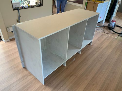

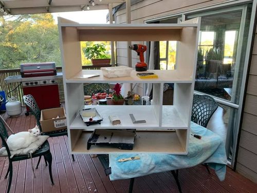

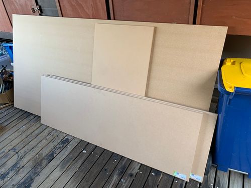

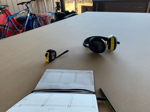

Then it was onto the carcass. I put the plans on paper and worked out how much mdf I needed, managing to cut correctly to use the offcuts too.

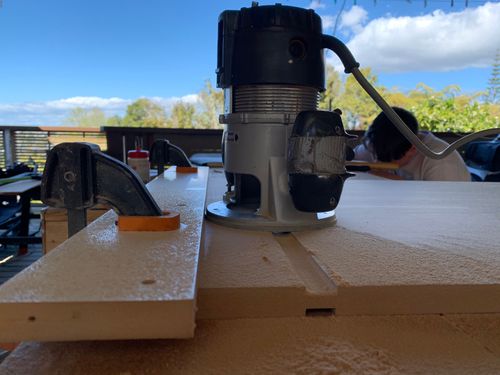

I decided to router the backing board and uprights so the whole thing comes together like a puzzle. Doing it this way really made it strong and required minimal clamping when it came to gluing.
The whole carcass is glued in the grooves I cut with the router. I didnt need to use any biscuits or screws except for the top board which I added for structural strength and to screw the hevea top to.
