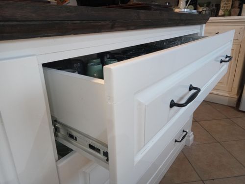

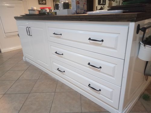

Hi Mitchell . The kitchen doors are raised panels ,I cut the doors in five peaces using a frame method and using sash clamps to glue together. the routed peace ( Raised panel) was used on a router table with feather board, you can also use a hand held router. The doors MDF are painted in auto Acrylic First with etch primer and then in gloss white followed by clear coat .All the materials I used are from Bunnings

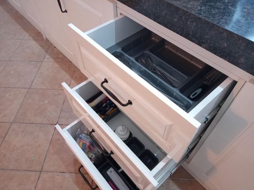

The kitchen carcass was constructed with melamine using a Erwin 80 touth blade to cut clean edge's. As a normal conventional blade will leave chips. The secret with melamine is to score cut your lines and then final cut .They where all screwed together with melamine stickers to cover screws .All materials including hinges and draw slides available at Bunnings
