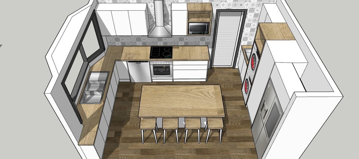

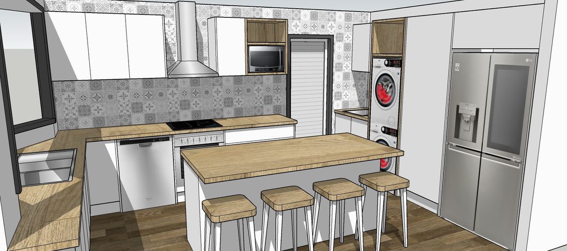

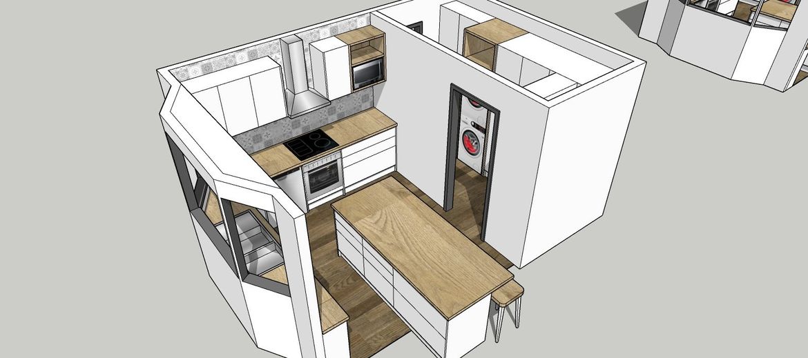

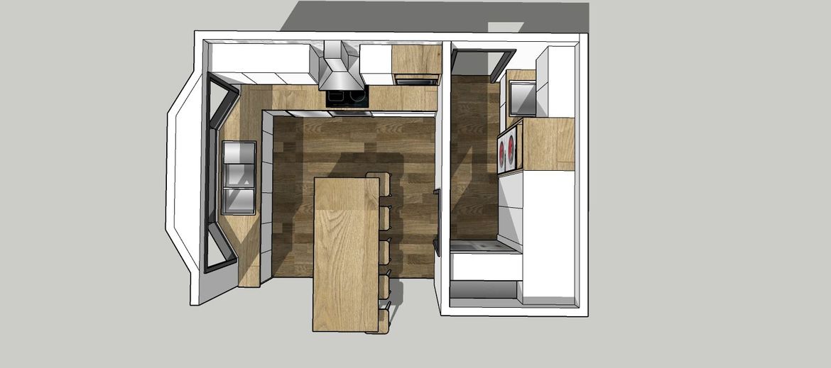

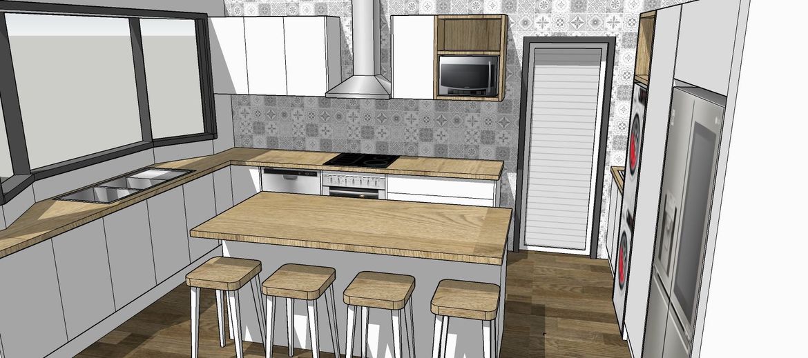

Hello @ckeij
Here are a few suggestions. One with the laundry wall intact. One where the wall is partially removed and finally an all in one integrated set but with the most space provided. enjoy the drawings and please post any questions you might have. I will upload the last three drawings on the following post.

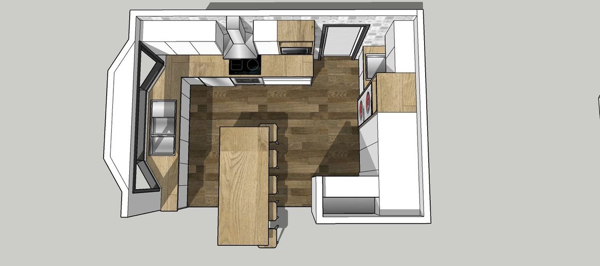

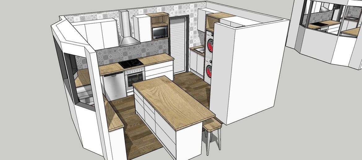

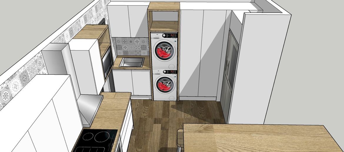

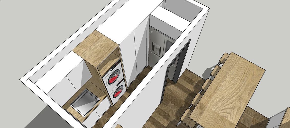

Hello @ckeij
Here are the last three drawings.

Re: Kitchen suggestions - Late 80s home reno
WOW! My husband and I are obsessed with the stand-alone island bench and putting the fridge in the back - it looks so slick and cool! Thank you so much for taking the time to do these mocks!
Did you draw these up using the Kaboodle planner? If so I am very keen to learn how you did the bay window in the mock ups!?
we plan on getting a kaboodle consultation in the next couple of weeks so we can price it all up!
Hello @ckeij
I'm glad you enjoyed the renders. The kaboodle kitchen 3d planner is versatile but it has its limitations. I used sketchup which is a little bit more feature friendly. But rest assured the cabinets I placed in your kitchen is all based on kaboodle cabinet sizes. Your Bunnings in home consultant should be able to rebuild this on their laptops and quote appropriately.
