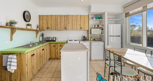

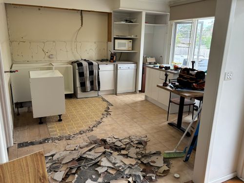

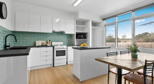

A few months back I had a job to install Kaboodle kitchen. The customer wanted to paint over the tiles and asked my opinion, which I replied "lift the old tiles as there are timber floorboards underneath that could be sanded and at there same level as the adjoining rooms. She loved the idea, but unfortunately I spend two days lifting and skipping the tiles and underlay, which exposed an old vinyl floor I had to also lift. My point is, check the original phot and the final one as this might give inspiration to your project 😬
Regards, NailbagBefore
Floor removal
After
