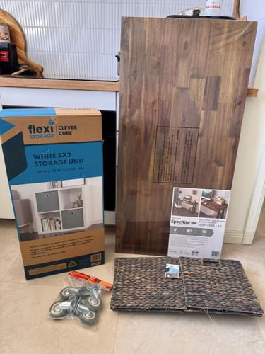

Impact driver (drill) with Philips head attachment.
Headed to our local Bunnings to grab everything we needed.

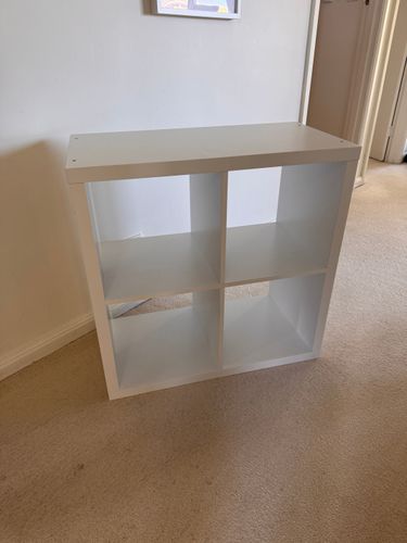

1 x Flexi Storage Cube 2x2
1 x Spectite Timber Panel 1200 x 600 x 19mm
2 x Flexi Stirage Cube Inserts
1 x 75mm PVC Castors 4pk
all for $150

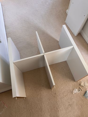

Built the Flexi Cube as per instructions

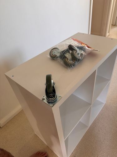

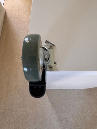

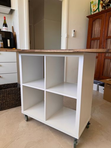

Added castors to the cube using 8G x 22mm timber screws (I had these left over from previous projects
I flipped the cube over on to the wheels locking them to stop it from moving.

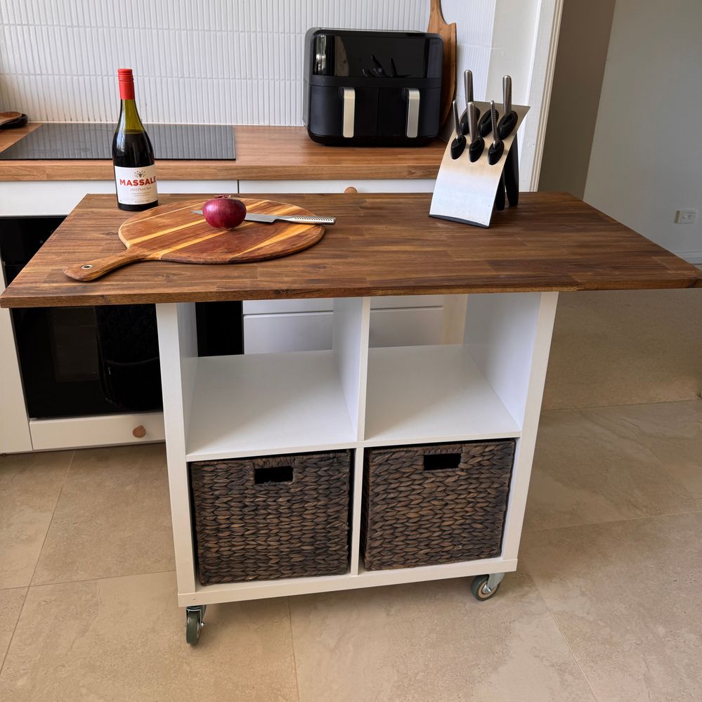

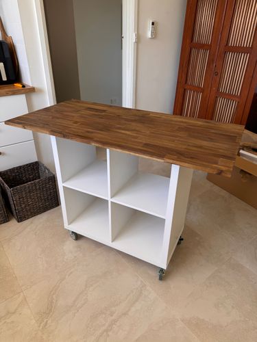

I then placed the timber panel on top of the cube and measured around to ensure it was in the middle.
I then used no more nails to glue it down (I also had this left over from a previous project)

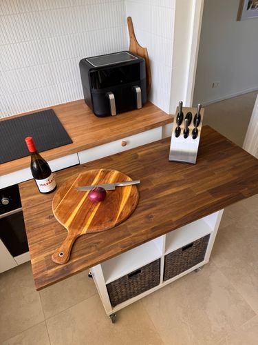

Styled and placed cube inserts into the cube
Nice work @craftyhopper!
This is a great solution to create some usable bench space in your kitchen that can be moved around when required.
Congratulations on a job well done.
